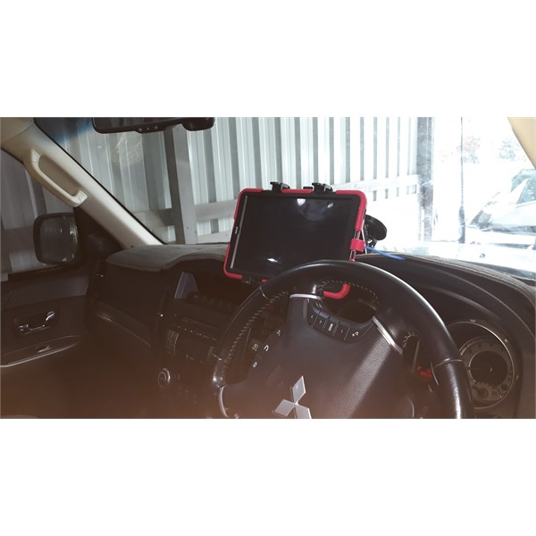

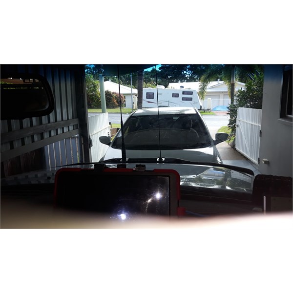

I use a Samsung 10inch tablet in the car . Custom mounted and it is great. It is just left of centre of steering wheel and line of site over bonnet is within legal limits. I find the big advantage is that a quick, simple and very safe glance from the road to the displayed map is a big advantage over having a smaller, dash mounted screen that requires a lot more concentration and eyes off the road time than how mine is set up. If I were to get another one I would get a 10inch tablet that will take a sim card for data.

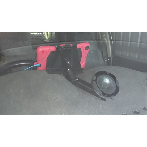

I used a large suction cup to mount to windscreen. Then extended the arm from the cup to the tablet holder. Positioned the tablet so it was in the right position and also manufactured 2 "arms or brackets " that attached to the back of the mount to give it mor stability when off road. It is very solid now. I also put some insulation on the rear to stop direct sunlight hitting the tablet (too much heat will cause the lithium battery inside to swell and tablet is cactus)...dont ask how I know!!! I also ran the power supply direct to my 120amp/hr lithium in the rear of the vehicle so the tablet stays in sleep mode and does not drain from the start battery. The 10 inch screen is far and away better than the previous 8 inch screen I had. When paried to the mobile phone it is good for web browsing and e-mails...something I dont do on the little mobile phone screen.

Bigfish, is it possible to get a pic of your mount set up and the insulation used. TIA. John

I can just see the top of the bullbar when driving so perfectly legal vision. This is in a 2014 Pajero Wagon. Tablet does not move . Mount was purchased from e-bay to suit a 10inch tablet. Same as this one...car mount
