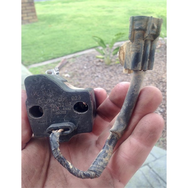

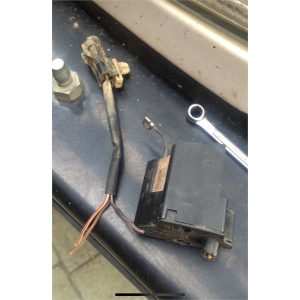

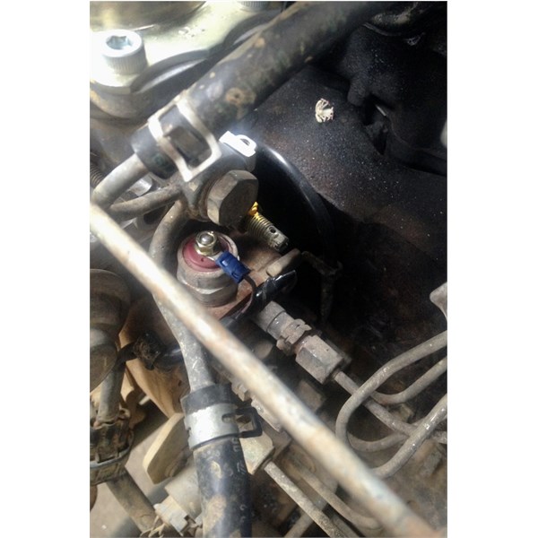

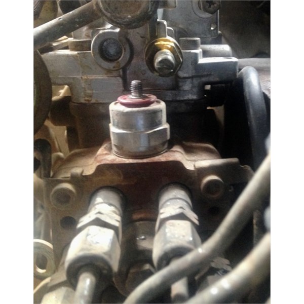

In short, you need to access this solenoid….it won’t look like that now, it’s covered with a black box pictured below.
Solenoid

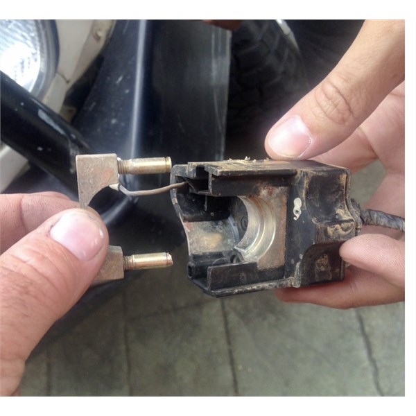

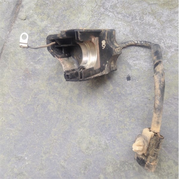

You need to remove the immobiliser unit that covers the solenoid…. You can drill out the break off security bolts, or I have heard people cut the unit apart with a multi tool, or in the bush they just got a screwdriver and hammer and broke it apart. You can see in the second pic that inside the immobiliser is a wire that bolts onto the solenoid, you need to access
the nut on the solenoid and undo
the nut, and remove that wire that’s inside the immobiliser ….don’t damage the solenoid though as you remove the immobiliser.
Pic 3… The immobiliser just clamps around the solenoid with the 2 security bolts that hold it on.
Immobiliser
Immobiliser
Immobiliser

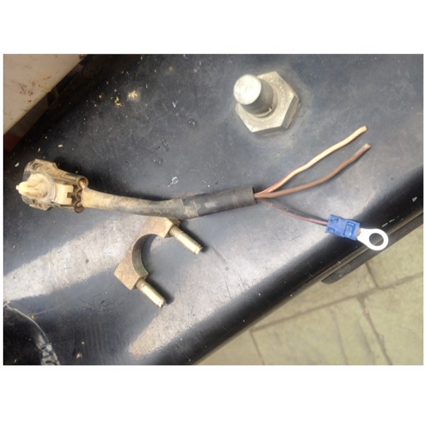

You then need to cut the wiring loom off the back of the immobiliser (this unit is what’s stopping your vehicle starting)
Cut wiring loom
Put a electrical lug on the purple wire of the electrical loom you cut off (insulate the other 2 wires)
Add lug
Then attach that purple wire onto the solenoid with
the nut you removed from it earlier, and plug your wiring loom back in…job done
Purple wire to solenoid
NOTE…you no longer have an immobiliser on your vehicle now, I have no idea if you can get replacements or what’s involved with reinstalling them…but your car will start fine now and not do what it was previously doing.
