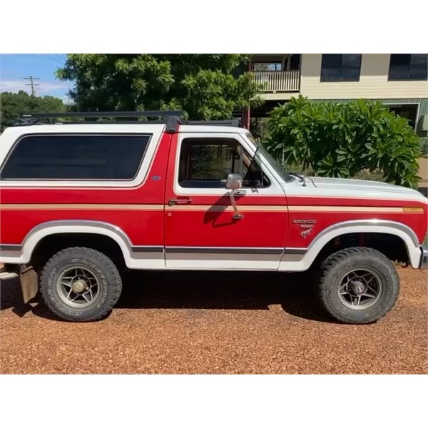

Ladies and Gents.
I would like everyone’s opinion on what engine to swap into my newly acquired 1985 bronco. The v8 petrol sucks too much juice although it sounds great.
I’ve have big plans to use this to tour the country and family camping.

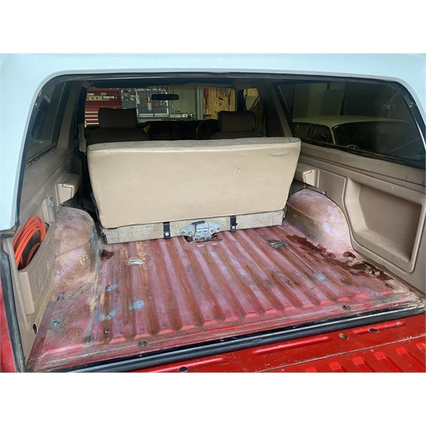

Not an answer to your question but a question for you to consider before tipping a lot of coin in this direction
Do you think this vehicle is going to be suitable for your intended use longer term? Not a lot of family and storage capacity compared to other options that may require less modifications

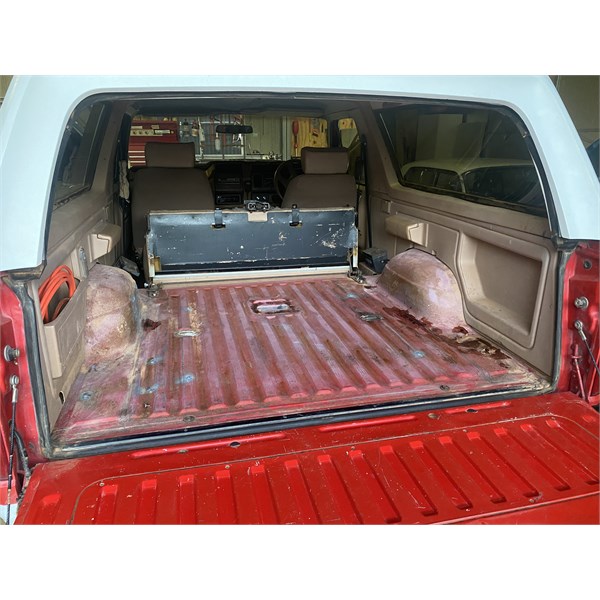

Reply By: Cameron C7 - Wednesday, Jul 07, 2021 at 17:16
Thank you yes she’s a beauty. I here your comment, but when i look in the back it can’t have any less room than say a prado. They are so wide. I dunno I do here ya, just thinking it is a sizeable rear compartment actually has enough leg room for me in back and I’m 6”3.

Follow Up By: AlbyNSW - Wednesday, Jul 07, 2021 at 18:22
Yeah fair enough if you are happy with it, just thought it was worth raising the point.
