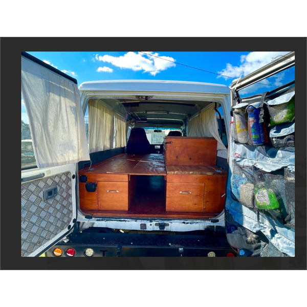

Im currently going through a road worthy for the 2004, and I cannot find the rear washer bottle for the rear window. I assume it will be a road worthy item.
If anyone has one of these, I would appreciate the help.

Thanks for the reply, Im sure I can find the hardware, but I cant where its installed from factory!

It should be in the rear on the drivers side above the wheel arch. If there is on cutout in the side panel you will need to remove it for access.

Thanks for the replies lads.... the blok I bought it off has put in cabinetry all through that region. I will have to install my own bottle...
At least I know where it is.. thanks again.

In your photo there is a dark section at the rear of the box that is on top of the drivers side bench. That looks like the original clip in cover to get access to the washer bottle. If you can get it out bingo youv'e found it.
