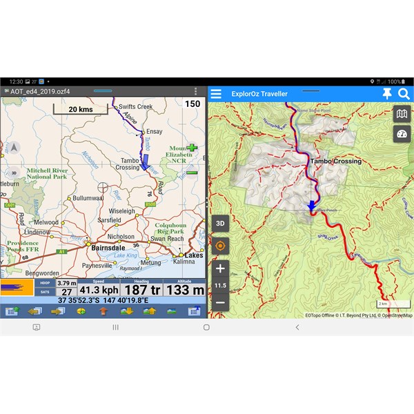

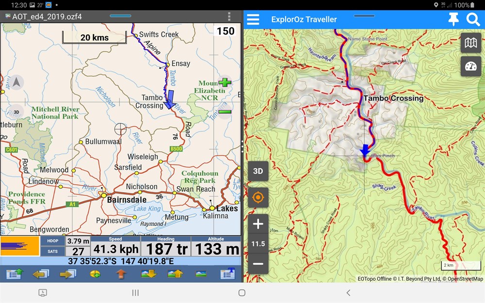

With a reasonably sized device you can run both apps simultaneously in split screen mode. They each have their advantages. You can slide the vertical divider left and right to give either app more screen as needs determine.
I use a Samsung Tab S6 which has enough grunt, RAM and screen real estate (10.5 inch/266mm) to make it a practical proposition. I have the same setup in my phone (Samsung S21) as a backup. The screen is large enough to run split screen at a pinch, but it is probably better to just swap between the apps and give each the full screen when needed.
When touring I like to see where I am in the big picture of things - my favourite map for that is Westprint Maps' Australian Outback Tracks 1:1M (shown in the screenshot) - and Traveller gives me the zoomed in detail without swapping maps as required in Ozi. Like Stephen L, I also have a large collection of 25k maps for Ozi so between them both I feel I am well covered for navigation.
