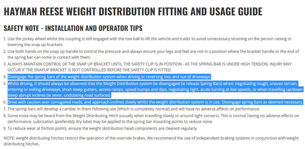

Follow Up By: Phil G - Monday, Oct 03, 2022 at 16:26
Frank,
When all else fails we could read the instructions.
This is from Hayman Reese. I'm hoping you don't tell me that Hayman Reese as well as the Chief Engineer at Cruisemaster are both wrong!
FollowupID: 921114

Reply By: Phil G - Monday, Oct 03, 2022 at 20:04
On a rough/corrugated road the WDH is of no special benefit and can potentially damage your vehicle which is why Hayman Reece and others tell you to disconnect them.

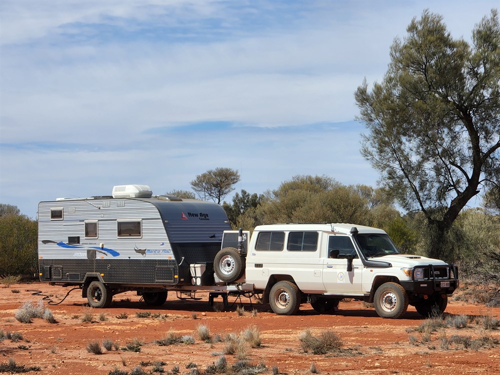

I tow a 2.5T offroad van and I like to take it offroad. There is no way I'd want a WDH. And in any case my Troopy/caravan sits level so doesn't need one. Photo taken in GVD last month.
