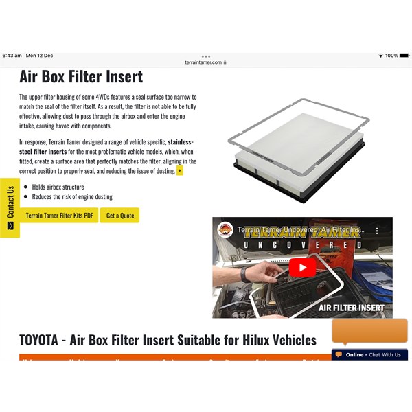

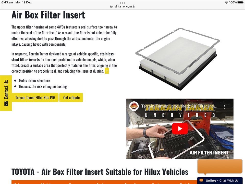

Follow Up By: Bob Y. - Qld - Tuesday, Dec 13, 2022 at 07:50
I had some light dust in my 79 series ute, Dave, and fitted a Terrain Tamer shim kit. Results since seem good, with a Plenty H’way/Simpson Desert crossing, producing no dust whatsoever on the turbo side of the filter element. A good fix at about $120.
Kits also available for 200, Prado & Hilux.
FollowupID: 921798
Follow Up By: DaveO*ST-R - Tuesday, Dec 13, 2022 at 12:30
Thanks Bob, some time ago I had investigated the idea of trying this out and have seen both positive and not so positive reviews. I might just have to try it out. Not expensive and can only help firm up the air box itself from flexing with the huge air intake of the V8.
FollowupID: 921802
