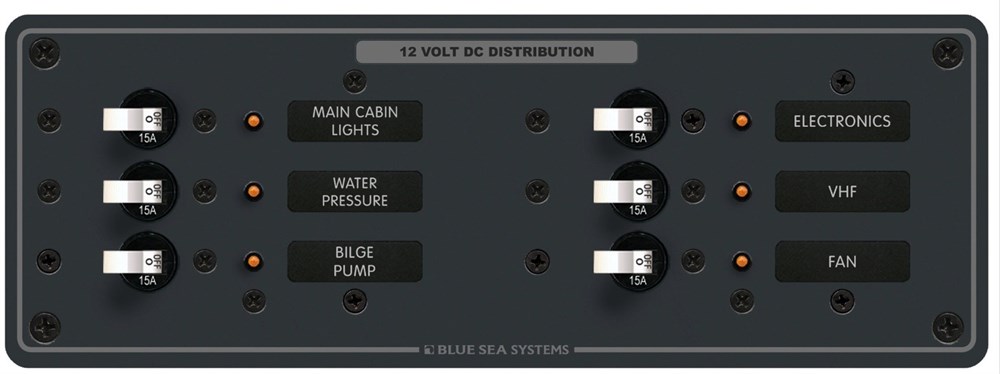

Not sure if this will help. I did something similar in our car & it has worked well for us over the past 5 years + of full time travel. By 'worked well' I mean it has done the job in an easy to use manner, & on the rare occasion that we have had any problem the problem solving process has been straight forward.
The main differences to what you are proposing are two things on the load side of things.
1. I used a Blueseas circuit breaker distribution board utilising switchable magnetic hydraulic type circuit breakers. This allows the circuit breakers to double as switches so no need for additional switches. They are ultra reliable & less in the circuits means less to go wrong.
2. I used power from this circuit board to switch a relay to operate our PX07 compressor, powering the compressor from the vehicle's start battery. It has a fairly heavy current draw & I think it better to use it from the start battery whilst the car is running on a fast idle.
I used a 6 position distribution board which can handle a a max of 100amps total with a variety of CB sizes from 5 to 50amps (the latter for an inverter used with a Makita fast charger for 18v batteries- 30 amp proved too small & would trip). This is not my actual one - a photo off the Blueseas web page the same as mine.
The Circuit breakers I used are the C Toggle type.https://www.bluesea.com/products/category/14/33/Circuit_Breakers/C-Series?Actuator_Style=Toggle
Easy to put together.

Cuppa thanks for your info and diagrams. Looks like there are no retailers for BlueSeas in South Aus so will look at online options. Looks like it will be a good option. I am happy to pay the money for quality gear. The reason I have looked into Narva is every quote from Auto sparkies I have received on previous jobs has used Narva. Good to know there are other options.

Whitworths sell Blueseas gear. They are at 85 St. Vincent St, Port Adelaide 5015
Phone 08 8240 3777
Website here.

Most Blueseas retailers are in the boating sector.
Plenty online do mail order.
BCF sell some of their stuff too.
Worth doing a bit of research, prices can vary quite a bit, or at least that's what I found when doing mine.

Trying to find a 5 switch 100a circuit breaker panel that will fit in the space I have then will run a separate small fuse block for the light draw Accessories.
