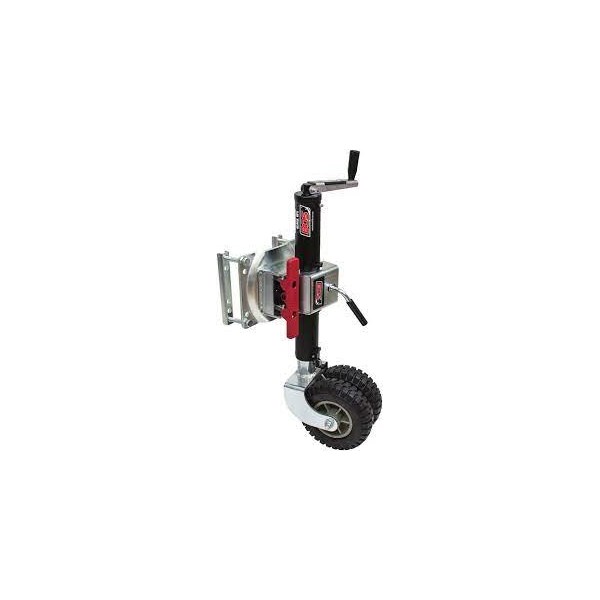

I have one of these for a few years now and I thought people might be interested in my experiences with it.
I have an off road camper trailer so the jockey wheel is really a bit of overkill. I wanted something that would make it easy to push the trailer around.
Much of my travel is on dirt roads
Overall I have been happy with it in particular as it does allow for the trailer to be pushed around while off the car. It is also obviously robustly built.
The wheel though is let down somewhat by a complete lack of dust proofing. This is disappointing given its advertised, supposed, extreme off-road credentials. The dust largely enters the internals by way of the holes in the external shaft just below the internal bevel gears. Adding to the grief is the recommendation to squirt grease into the works. As you would appreciate dirt and grease when mixed make for terrific grinding paste and can cause significant wear and tear issues. The issue also means that the wheel can become virtually impossible to wind up and down, especially down. Maintaining this is very difficult. As a partial solution I have wrapped insulating tape around the shaft covering the holes. This does help to a degree but I really cant see why Ark don't just cover them at manufacture. If you only travel on bitumen you may never notice this but then you may not buy an 'extreme' jockey wheel anyway.
In addition the blue plastic cap with the embossed company logo appears not to be u/v stabilised becoming brittle and fracturing. It is a ridiculous $20 or so to replace. The magnetic, removable (prone to getting lost) winding handle is about $30
The spare parts list is also incomplete. For instance it is not possible to buy the handle that is used to swing the wheel from the vertical to the horizontal position. There have been previous discussions here about replacing the thrust bearing which Ark do not supply.
Hope this helps in your decision making.

I should have added one other irritation about the wheel. It does have a useful feature in that you can position and lock the twin wheels through a range of degrees up to 180 when the jockey wheel is in the horizontal travelling position. This means you can have the wheels facing up so there is no real chance of hitting them when you are off road. The problem is that as you drive along your bit of off road the jockey wheel unwinds somewhat through the vibration and the wheel swings down. Of course the driver is unaware of this.
It is possible to prevent this by using a shock cord but bit of a nuisance.

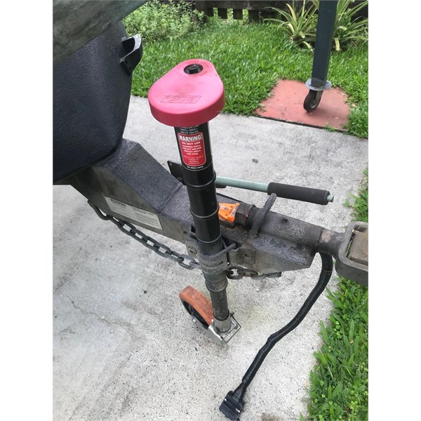

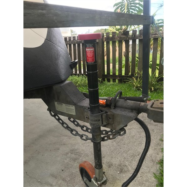

Yes , John, at $375 it's a bit pricey, but you do get quality and reliability and very easy to use. Bargain !!!
Jim
ps some photos ...... maybe !!

BUT, for an off-road van, it doesn’t swing up !! A real pain to remove it and store it somewhere while travelling.

Answer for Gronk, you can get a swing away one.

I don’t take it off. Just unpin the jockey wheel itself, store in the front of the camper, then use the drill to raise the leg as far as it will go and pin it in place.
Perhaps I’m lucky that I can still access the back of the DMax and lower the tailgate.
It’s just so easy.
