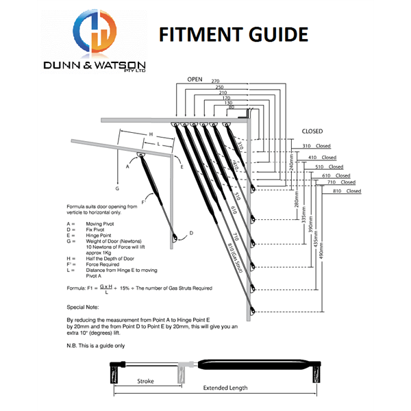

Yes you can.
This might be useful?
Alternatively, you could consider 12v linear actuators.
https://youtu.be/L2EOrguTzZk

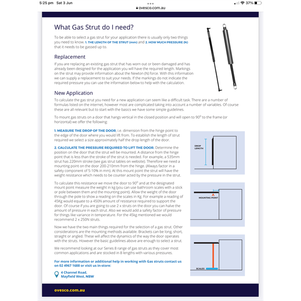

Follow Up By: Bob Y. - Qld - Saturday, Jun 03, 2023 at 17:30
This from the Ovesco website:
FollowupID: 923508

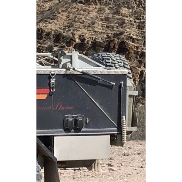

Kimberley Kamper have 2 struts on each side to aid opening and closing
AnswerID: 643755
