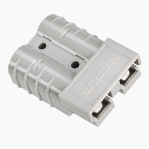

I did a stupid thing. I wanted to fit Anderson plugs to my 12v compressor so I could then use it either connected direct to the battery with the supplied alligator clips or the Anderson plug at the rear of the vehicle. I cut the wires to fit the Anderson plugs without marking which one was positive and which one was negative. So now I have one set of wires with red and black alligator clamps so that parts ok but the other wires going into the compressor are not marked.
Is there a way to determine which is the earth wire on the compressor. I can’t partly disassemble the compressor to chase the wire so hoping there is a simple way maybe using a multimeter.
