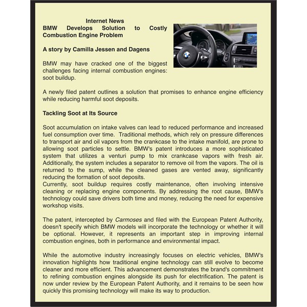

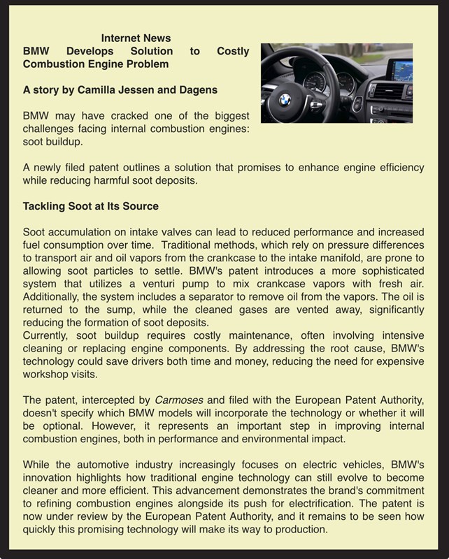

Follow Up By: Batt's - Saturday, Feb 22, 2025 at 05:12
All BMW have to do now is come up with a name for this "new" wonder device they can put a patient on.
About time one of the companies admitted there was an issue with the way the system works.
