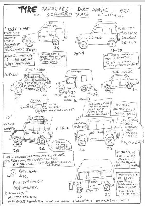

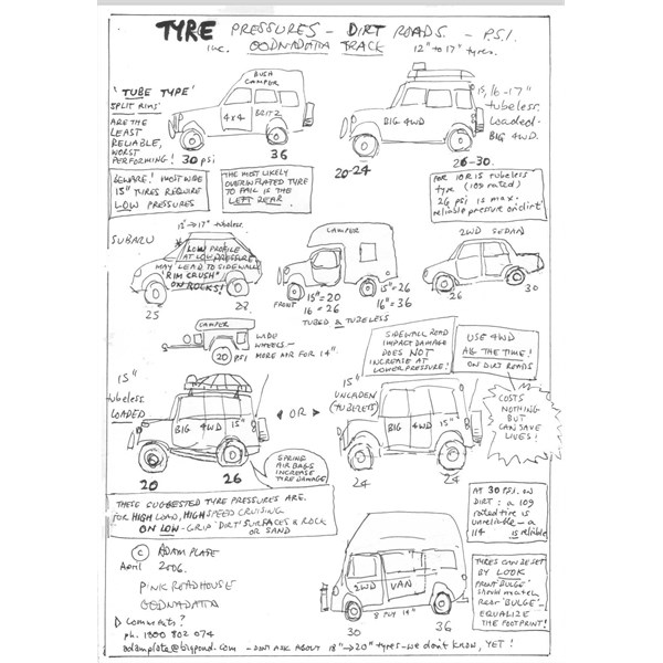

Bush cops drive fleet cars….. I’ll stick with Adam Plate’s and other’s rules of thirds. One third out on dirt, second third out on sand - roughly. Tyre chipping is as much an issue for overinflated tyres on outback graded dirt with chipped rock - who can afford that these days haha.

Suggest you give the person a copy of the late Adam Plate Outback Tyre Pressures
When he was alive, if you spoke to him it was his pet talk

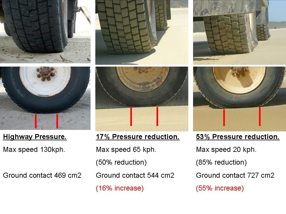

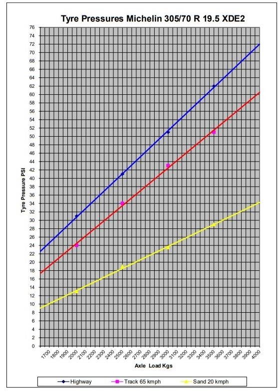

Reply By: Peter_n_Margaret - Wednesday, Feb 19, 2025 at 09:22

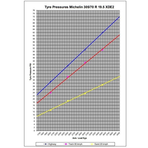

Michelin publish speed Vs Pressure Vs load carried data for the tyres I use on the OKA.
I have converted the Michelin data to a chart for my own use. I have use it religiously for 20 years.
Blue represents highway speeds, red is 65kph, yellow is 20kph.
AnswerID: 647429

Follow Up By: Allan B (Sunshine Coast) - Friday, Feb 21, 2025 at 19:53
As Peter said, that chart is for the tyres he is using.
The chart does not necessarily apply to other tyre sizes or brands, but you may find the appropriate data for your tyres on the Michelin website. I had a look on Michelin and got lost but if you ask nicely, Peter may even tell you how he did it.
Bear in mind that the ambient air and road surface temperature will have some effect on the equation and Peter's chart does not indicate any ambient temperature, so????
FollowupID: 928487
Follow Up By: Peter_n_Margaret - Friday, Feb 21, 2025 at 20:37
The data is often difficult to find.

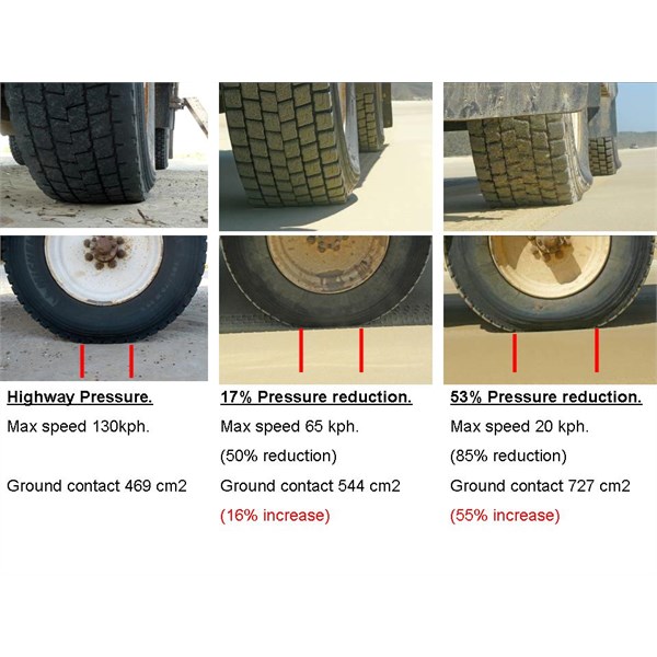

At the time, Michelin had an Australian technical specialist who happened to live in Adelaide and I got it from him.
These pics are also based on that data.
I can't publish the original data because it is copyright.
FollowupID: 928489

However the degree of pressure reduction is directly related to vehicle total weight, just as Peter's chart indicates.
