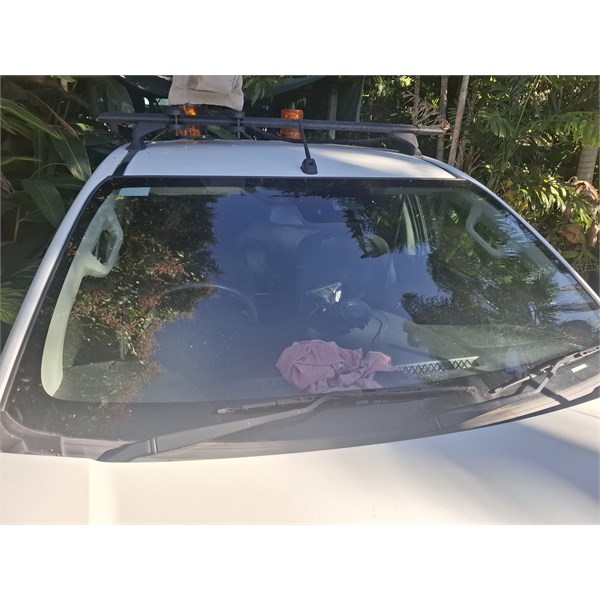

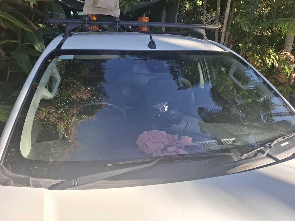

I have a HN7 gps and works fine in my Pajero and also in Ford Ranger ute I recently used for work. Last week I tried to use it in a Triton ute at work and it lost satellite reception. Goggle suggests that FM radio or crash camera can interfere with gps. Strange that it worked fine in Ford Ranger which had crash camera and radio similar to Triton. I tried a couple of different positions for gps in Triton but didn't help.
Anyone else experienced this issue and worked out solution?

Interesting handle for someone who is still working. Does the Triton have a “metalised” band in the windscreen?

Looks like a normal windscreen to me, with camera in front of rear view mirror. The Triton has a camera mounted on the roof to record road conditions, this camera has a gps on it as well. Inside ute there is a Hummingbird gps rally meter that works fine.
Maybe the additional electronic gear on ute interferes with Hema gps

Maybe its got a metallic windscreen treatment.
https://www.neltronics.com.au/pdfs/Radar%20and%20GPS%20mounting%20position.pdf
