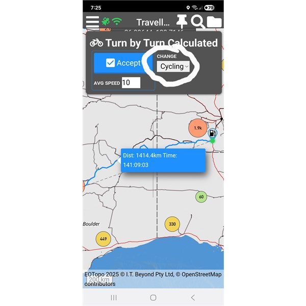

Trying to get directions along the great central road but only getting a direction and distance as the crow flies. What am I doing wrong ??

Reply By: Member - nick boab - Saturday, Nov 01, 2025 at 20:33
Ngardanginy , Are you talking Traveller ?
AnswerID: 648652
Follow Up By: Ngardanginy - Saturday, Nov 01, 2025 at 20:41
Yes, exploroz traveler.
FollowupID: 930095
Follow Up By: Member - nick boab - Saturday, Nov 01, 2025 at 20:57
Ngardanginy , probably need to give full details of how you have gone about it . Should have been pretty straightforward I would have thought ?
P.S start & finish points
FollowupID: 930097
Follow Up By: Member - nick boab - Sunday, Nov 02, 2025 at 08:01

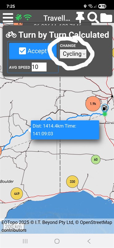

Ngardanginy, try changing your mode of travel to cycle.
FollowupID: 930098
Follow Up By: Ngardanginy - Sunday, Nov 02, 2025 at 10:01
Changed to cycling and now have the details of the road.
?? thanks mate.
FollowupID: 930100

Rocco, probably is wanting Auto routing for the journey ? On the Traveller app.
FollowupID: 930096

Follow Up By: Member - nick boab - Sunday, Nov 02, 2025 at 08:12
Michelle, That won't explain why the straight line navigation ??
When I tried it, it took me the long way around via the Nullarbor.
I was a bit surprised that I had to change to cycle mode to get it to navigate the Great Central Road..
