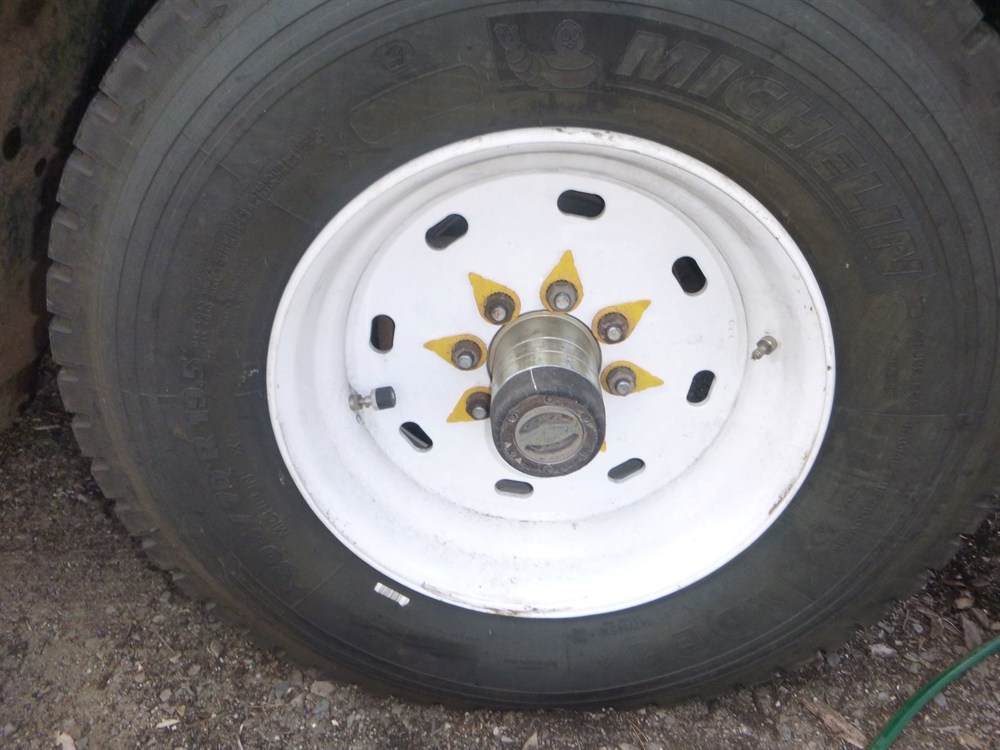

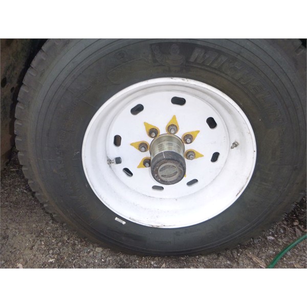

Reply By: Peter_n_Margaret - Sunday, Sep 06, 2026 at 12:04
We do lots of bush driving in all sorts of conditions.
I have metal valve stems and added extra valves that are further back for protection of the monitors.
They are mostly for the convenience of changing air pressure without removing the sensors, but it also adds extra protection.
AnswerID: 649546
