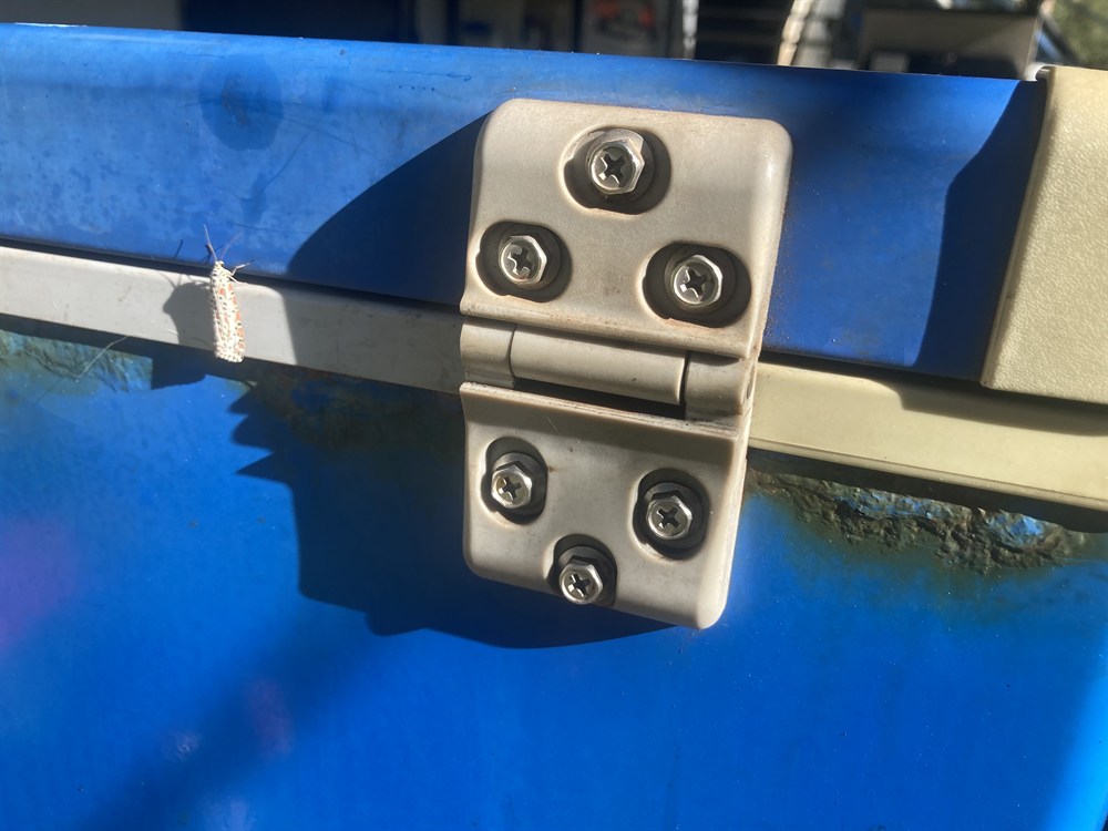

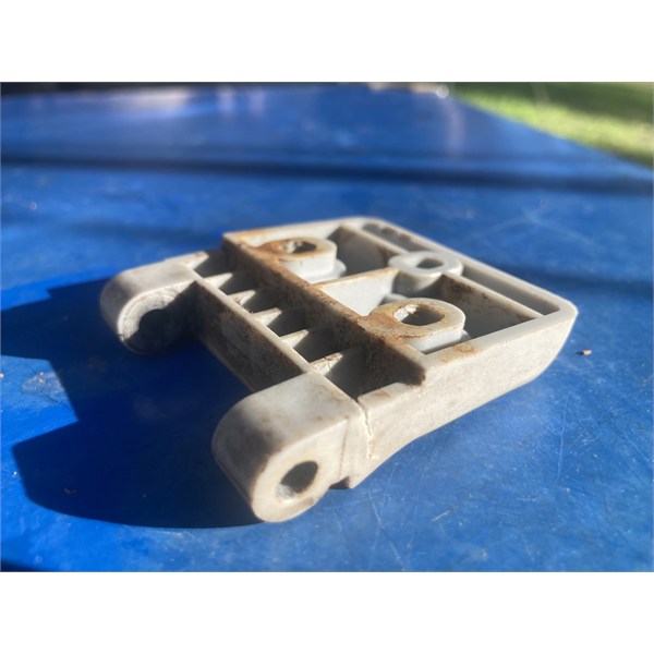

Hi guys. Have a YCD90A kings 90 l fridge freezer which is an ever cool apparently. I can't get the hinges from either and were wondering if any one had come up with a supplier or an alternate hinge that fits. The fridge is fine. Can't really screw a different hinge on because there are threaded nuts in the lid to suit.

If you value the fridge I would scrape and treat with a rust killer, wherever the Tin Worm is destroying the case. Then Repaint.
Also a STAINLESS STEEL hinge could be easily made, if you can remove that one, and have dimensions of/for ALL the Bolt holes spacing etc. Presuming it is flat on the rear side it is quite possible. If you supply the dimensions of hinge and hole pattern I could make you one if needed. Not really hard to do!

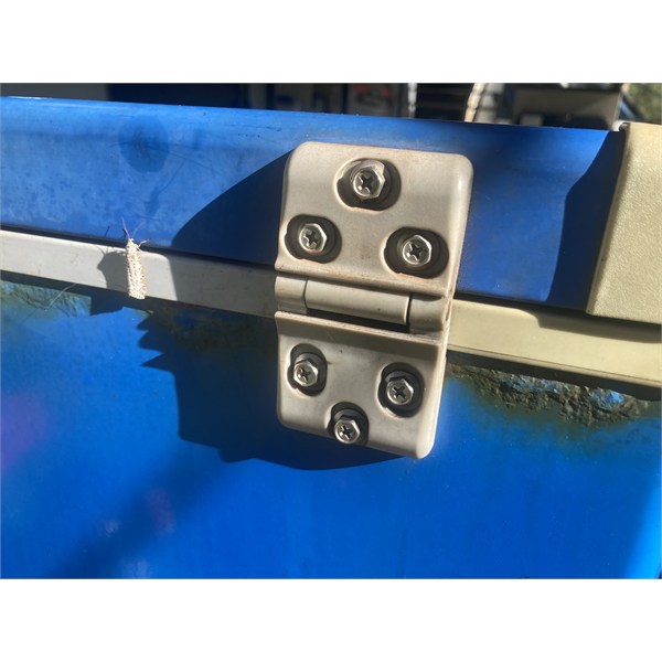

Here you go Kirk. This is a replacement for IceKool and looks identical to your pic.
Good old Tentworld Link here.

Sorry Kirk, I missed that "sold out" expression.
Try this one then, looks the same.

I don't think they are the same. Pretty sure. Mine fix with small metal threads not screws. I think I've come up with a fix anyway. They are not broken completely just cracked. They have pockets in the back I think I could fill up with araldite or similar and get away with it. Thanks anyway.

Why would you use araldite? You said it has threads (or I think you said that) in the Lid. can't you unscrew the Hex heads and replace the hinge?
It appears to have three threads above and below the lid line on each side. Just use the threads which are there, OR is there something you aren't telling us YET! The LID and Base must have sufficient Threads for the OE screws to fasten to!

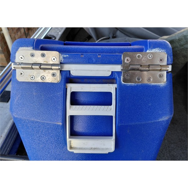

This is what I did got a couple of stainless steel hinges and screws and a good quality silicone

That could work. Not sure what's in the fridge material to screw into. As said somewhere I'm going to beef up the hinges I have as they are only partly cracked thru. I'll

This esky is only very thin plastic and screws doesn't do much, the silicon does most of the work, just need to find the right type i think .

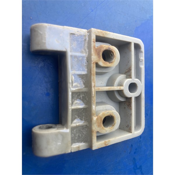

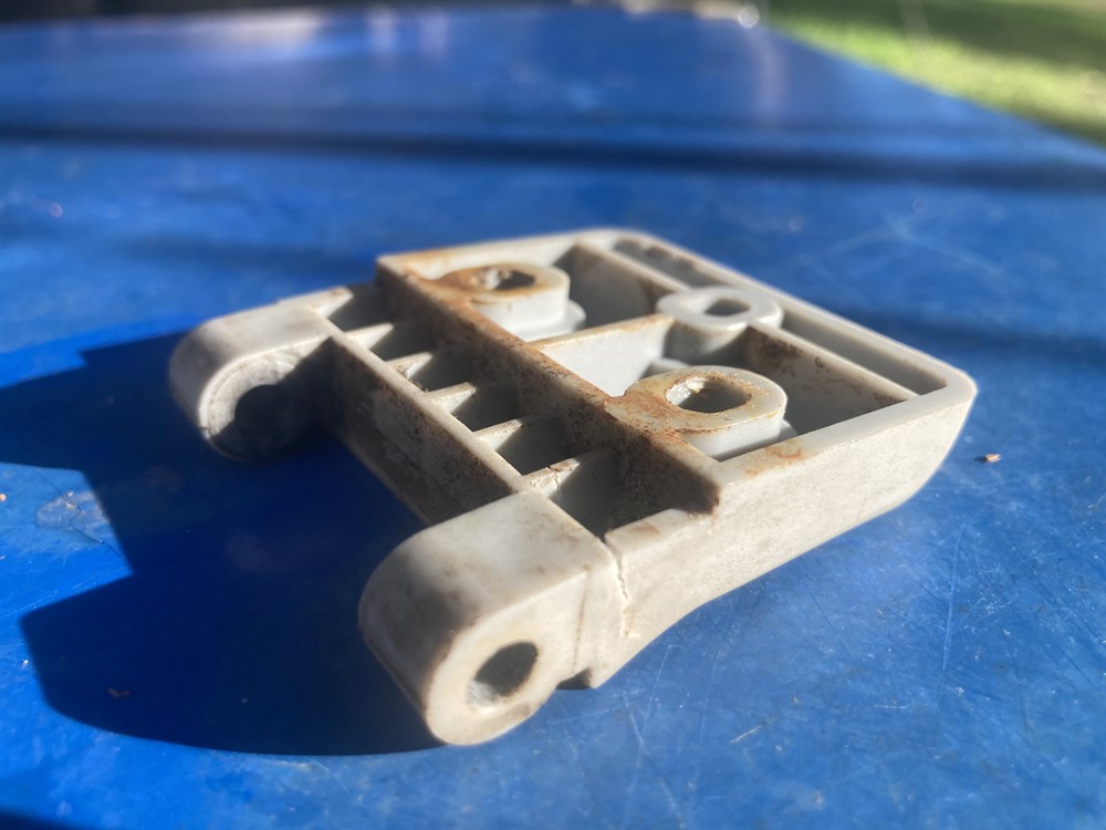

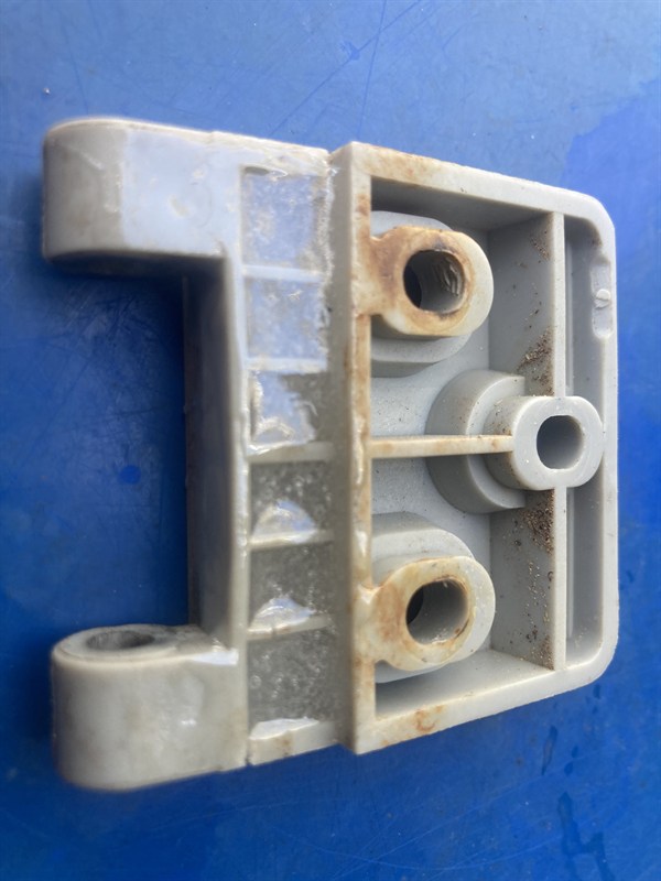

The hinge is cracked as per photo. Probably didn't explain well but if I fill the voids or little squares shown with araldite I think it will be ok. But thanks for all the ideas. If my brainwave doesn't work I'll try those.

Kirk.
Unless you can roughen in the internals of the square voids, the Araldite won't adhere to the plastic. It won't stick very well anyway! To be of use, Araldite would have to have a TENSION STRENGTH, which is POOR anyway.
Because of the stepped face, any flat hinge with a suitable thickness packer will make it a secure hinge system. With the forces applied to crack the OE hinge, the Araldite will simply GIVE UP too!
FIX it PROPERLY ONCE, then all is OK!

I used JB weld. See how it goes.

Kirk, the hinge is probably manufactured from acetylene resin, glass-filled nylon or one of the ethylene materials, all of which are difficult to bond with epoxies. However, if I was to try, I would use JB Weld as you have done. Araldite has low tensile strength.
Bit late now but sometimes in similar situations I have drilled a countersunk hole or two in the product so that the JB Weld flows through and form a rivet effect rather than relying solely on the surface adhesive for strength. Always effective. But what you have done may do the trick.

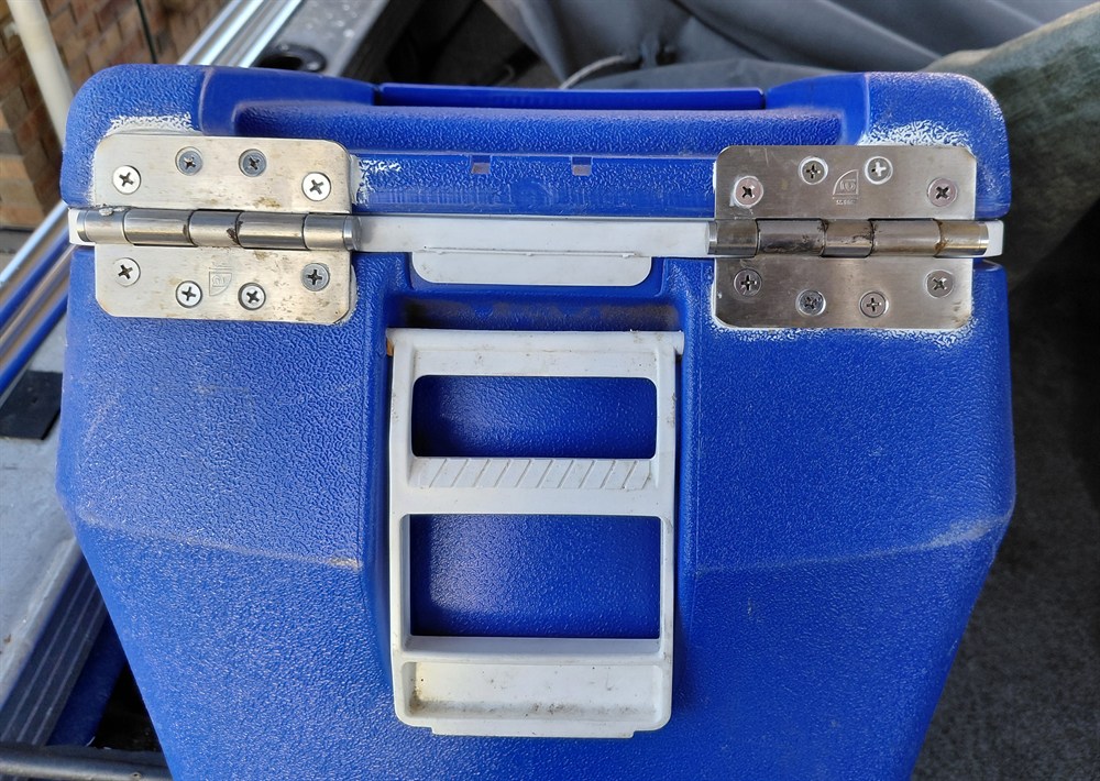

Here is one I have used in a similar situation the you have
AnswerID: 649565
