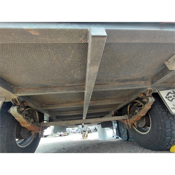

When you look at the RTT, the biggest issue is getting changed, there is simply not enough room to stand up in them...so people have been putting on side annexes etc.
There is another issue is getting up and down the step ladder, yes when you are younger, there was hardly any issue..but as the years get on...
The attachment of the RTT to a trailer is a good idea, it negates the climbing issue but again, space for changing etc still comes into play.
I came across this little gem...Mountain Trail MDX hard floor camper trailer
FollowupID: 931450

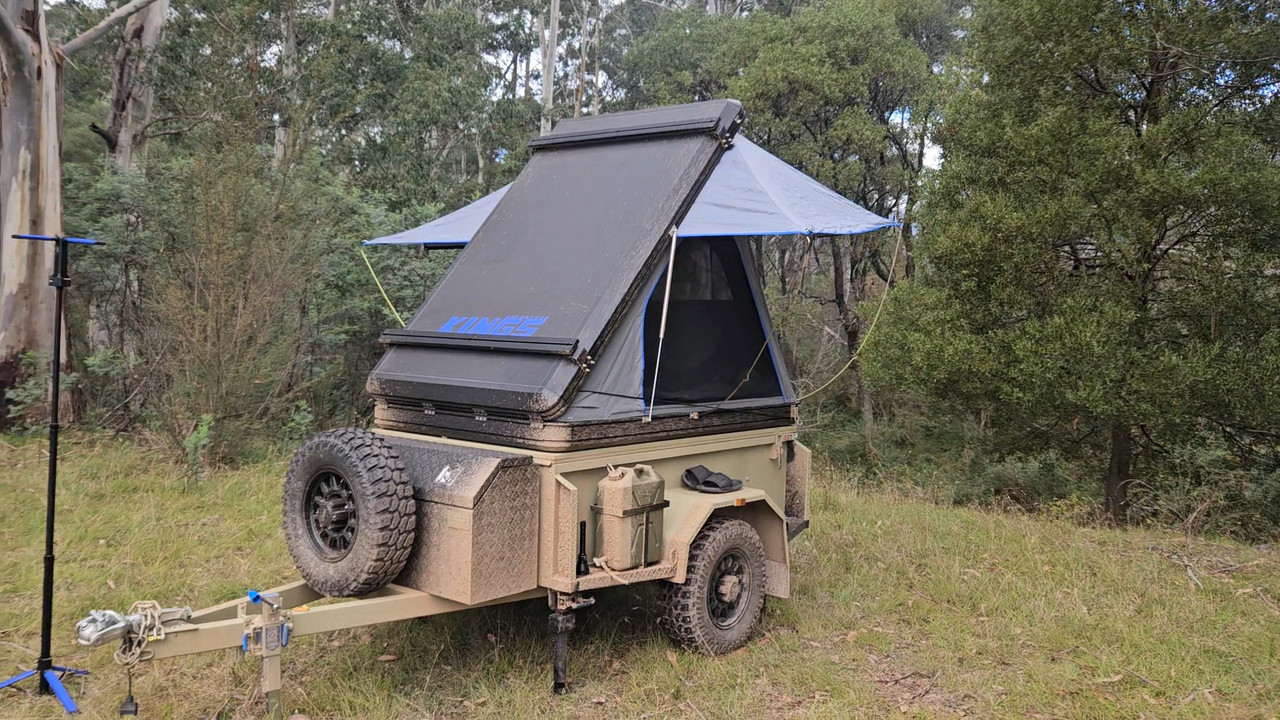

Reply By: Member - Bigfish - Saturday, Sep 26, 2026 at 07:30
I bought a second hand 8x5 heavy duty trailer. Put 4wd rims and tyres on a good spring suspension set up. Put 3mm ally sheet on a frame. Mounted with 3 heavy duty hinges. Telescopic/air rams for the lift. Mounted a roof top tent. Installed gas bottle, 200 lithium battery and associated charging /outlet gear. Used plastic fish crates with lids. Off road hitch and electric brakes. Roof top tent mounted to lid. All up under $10k. Had it for 5 years and was 100 times better than a roof top tent on a vehicle. Carried all my camping gear in the trailer. Jerry cans behind each guard. Spare wheel on drawbar. Put a second hand swing out kitchen on the tail gate. 3 x 20 litre drums for water. Simple yet very easy to maintain and effective. I've had 3 camper trailers in my travels and they are heavy, slow to set up and cost a hell of a lot more than the basic trailer set up...which can also be converted back to trailer quite easily if designed correctly.
AnswerID: 649604

Follow Up By: Member - Bigfish - Monday, Sep 28, 2026 at 06:40
I had my RTT on the trailer for 4 years and mainly off road use. Suspension will handle the weight easily. Never had a rock or dust issues at all. The lid on the trailer had a 8mm neoprene rubber type gasket to keep dust out of contents in trailer (same as on tailgate).

From what you are describing sounds much like the old style fold out soft floor camper trailer but with a rooftop tent on top rather than the fold out .
We have a Sar major camper trailer that are built in South Australia , that we purchased in 2012 very basic but unbelievably reliable. Live axle and leaf springs that has not let us down in all epic adventures over many years
It's about 4ft plus x 6ft inside . We paid $6,500 for it for basic trailer and canvas tent top in 2012. Have made a few modifications to it over the years.
It's a cheap way to get into something that doesn't cost a lot of money and this style of camper might suit your needs .

Follow Up By: Member - nick boab - Sunday, Sep 27, 2026 at 09:53
Mark, I couldn't find any good photos online just the video on their website but that was just to give you an idea of using a basic camper trailer .
trips we have done in this camper include three times on the Gibb including kalumburu and Mitchell plateau Cape York limmen np tanami Birdsville Oodnadatta etc , you may be able to see some on my profile page .
FollowupID: 931459

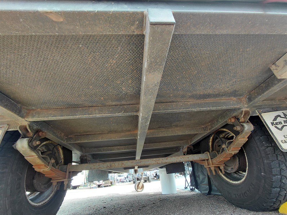

Follow Up By: Peter_n_Margaret - Sunday, Sep 27, 2026 at 10:48
Observations/suggestions..... :)
Nice looking trailer.... but.....
Those springs appear to be either overloaded or due for replacement. Look at the hanger angles.
If a BIG bump was encountered, the hangers would hit their limits and there would be a significant risk of breaking a top leaf eye off. And I like longer hangers personally.
No dampers?
No bump stops?
FollowupID: 931463
Follow Up By: Member - nick boab - Sunday, Sep 27, 2026 at 11:47
Cheers Peter, agree with that , original from 2012 . I can see where the shackles have been hitting when they bottom out . But they have done some work over the years of out back travel. The basic trailer has been very reliable w no cracks or brakes, except shackle nut coming off once .
At the moment the trailer is full up of red wood for our week camping on the river .
FollowupID: 931464
Follow Up By: Peter_n_Margaret - Sunday, Sep 27, 2026 at 12:30
Bit off topic now????
"I can see where the shackles have been hitting when they bottom out."
That is why I would prefer longer shackles, then the springs can be flattened completely (and be at their longest length) without the shackles bottoming out.......BUT it is then possible that they can go inside-out on the rebound and solution to that is bump stops that also act as the last stage of the suspension.
FollowupID: 931467

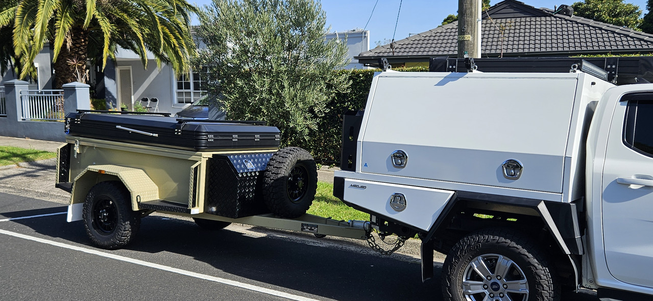

Reply By: grunf - Sunday, Sep 27, 2026 at 08:35
I got this. Stupid and simple, but bulletproof concept. No ladder needed, step on mudguards to get in from the sides. Storage can be open with tent fully opened, so can the front box.
Trailer on rebound leaf springs. Lid and tailgate sealed with rubber seals, very minimal dust on lengthy corrugated roads.
Over the years I had number of different setups, camping is my second life. If any information needed please reach out.
AnswerID: 649611
Follow Up By: Member - Mark B68 - Sunday, Sep 27, 2026 at 10:12
Cant see images......
Would it work out to the same cost as some of these ??
FollowupID: 931461
Follow Up By: grunf - Sunday, Sep 27, 2026 at 10:24
No sure why you can't see images. I confirmed that other people can. Maybe try using different device, like mobile phone without logging in etc.
My setup costed me way under $10k and thats including tent (all you can see in photos).
Based on what you described in opening thread, this is exactly something what you are after.
FollowupID: 931462
Follow Up By: Member - Mark B68 - Sunday, Sep 27, 2026 at 12:03
Images work fine on phone just not on PC/Chrome or Edge ? Weird
FollowupID: 931465
Follow Up By: grunf - Sunday, Sep 27, 2026 at 15:47
So is this kind of setup something you had in mind?
FollowupID: 931470

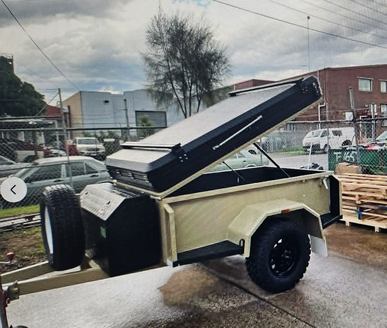

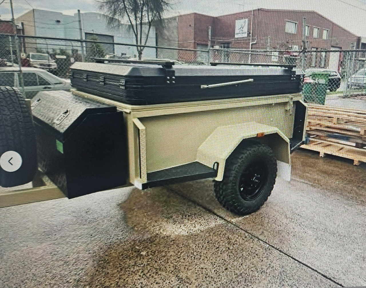

Follow Up By: Member - Bigfish - Monday, Sep 28, 2026 at 06:43
Similar set up to mine. Well under hald the price of those in the photos. My trailer was 8 foot. This one looks a bit smaller. The extra distance allowed me to carry some gear on the lid if needed. This looks like a great setup. Simple and cheap.
FollowupID: 931473
Follow Up By: Member - Mark B68 - Monday, Sep 28, 2026 at 06:58
That trailer would do the trick I guess... plenty of storage as well....
What was the cost? Is it for sale ?
FollowupID: 931474
Follow Up By: grunf - Monday, Sep 28, 2026 at 22:18
I would consider selling it for the reasonable price. Send me an email to grunflovac@gmail.com if interested as I cant send you message here (Im not a paid member).
FollowupID: 931476

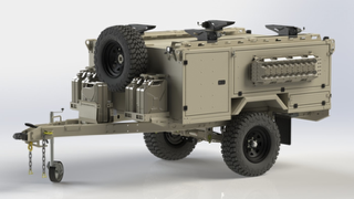

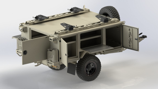

Reply By: Member - McLaren3030 - Monday, Sep 28, 2026 at 07:32
Hi Mark,
This might just be what you are looking for, not sure of the price, as the website didn’t have any prices listed. The company is called Land Force Defence and Mobility Trailers, I tried to get the link to copy but I couldn’t make it work. If Google landforcedefence.com The one I thought might work for you is the CS-4.1 Reconnaissance Support Trailer. There are various configurations. See photos.
The company manufacturers in Brisbane, Steel chassis, aluminium body. It looks like you should be able to mount your RTT onto it. You would still need a ladder, albeit a much shorter one.
AnswerID: 649612
Follow Up By: Member - Mark B68 - Monday, Sep 28, 2026 at 11:24
Bit over the top unless wrong link :-)
Offroad trailers
FollowupID: 931475
Follow Up By: Member - McLaren3030 - Tuesday, Sep 29, 2026 at 07:41
That is the company, but it is a different page to the one I went to. The Tactical Support Trailer is the one in the photos I copied into my last response.
FollowupID: 931477
