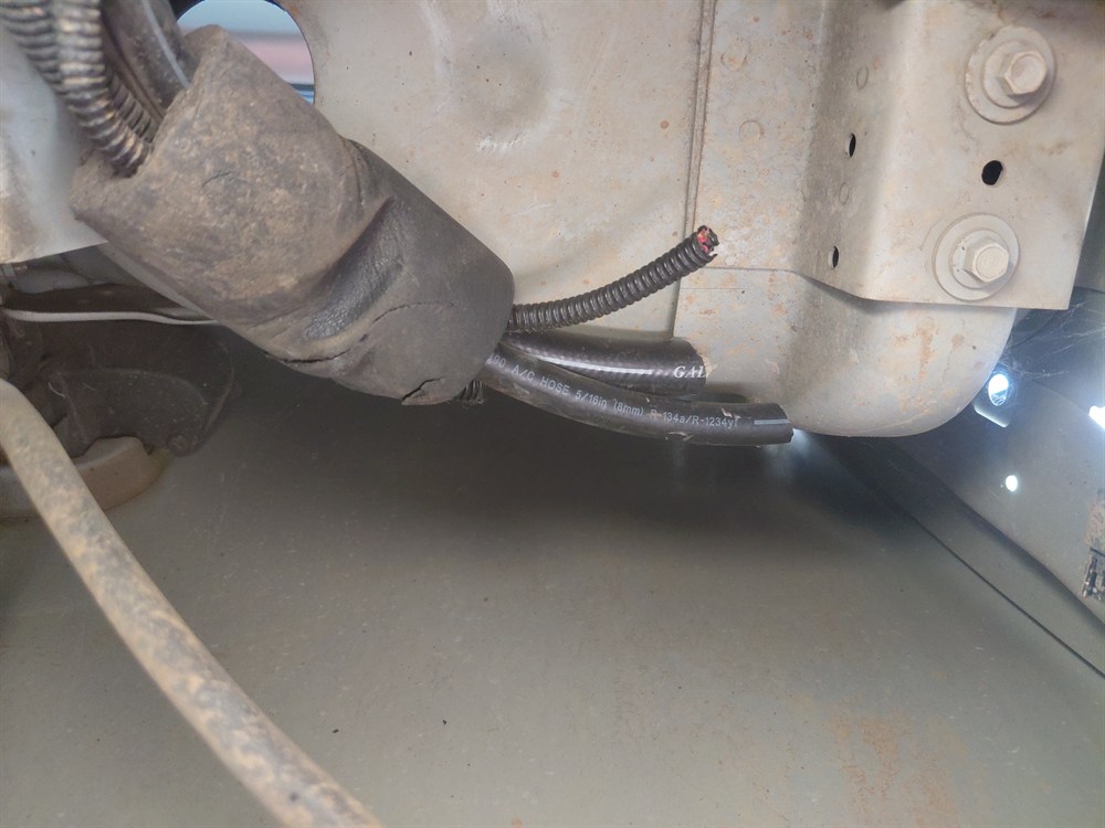

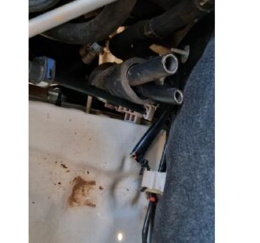

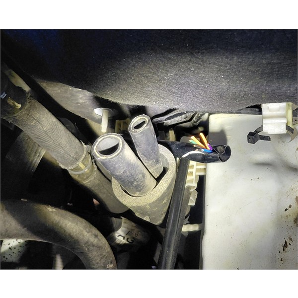

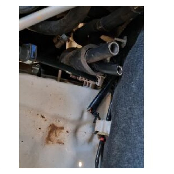

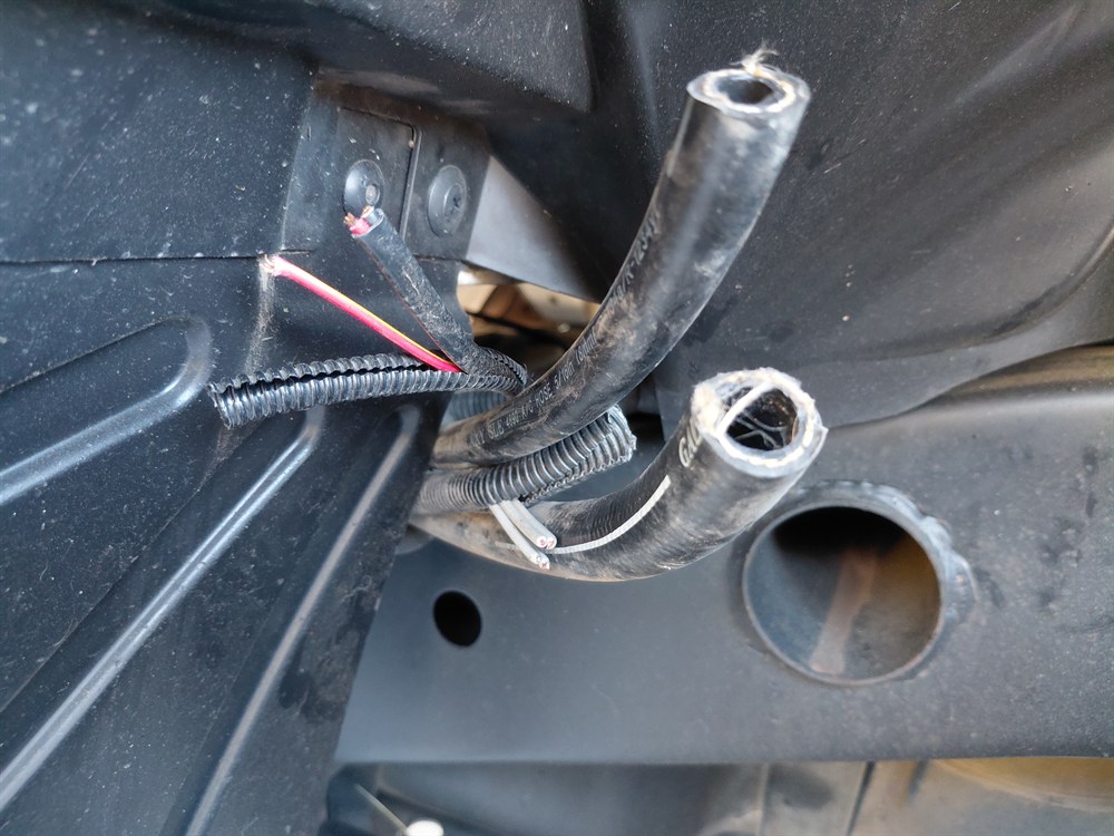

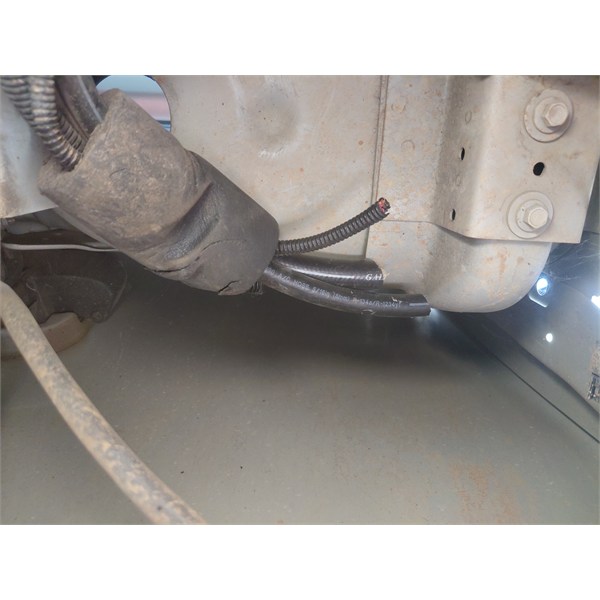

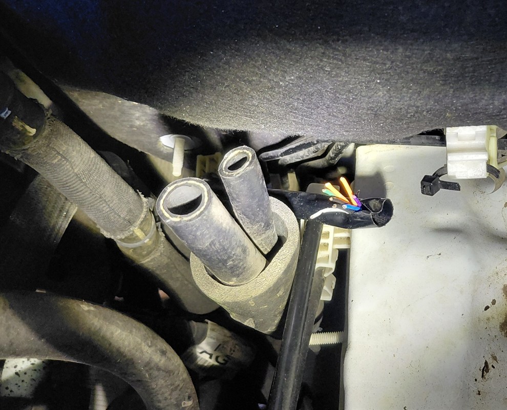

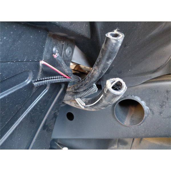

I'm in the process of purchasing a second hand ute "upgrade" its had some sort of accessory removed and I was wondering- curious to what it may have been ??
2 fuel light tubes running from the tub to under the bonnet along the chassis with electrical wires and a orange blade fuse .
Has anyone any idea on what this may have been thanks just a curiosity question seeing the forum is very slow at the moment lol

Thanks peter . There are 3 wires, & a 2 pin plug under the passenger side Dash with two wires one going to Earth. Can't see where the power comes from for the fuse under bonnet. The vehicles is still at the yard and I'm yet to pick it up.
But auxiliary fuel tank sounds most likely.

Thanks Macca . Can't really see anywhere where the pipes may have been connected to or the wires.
They have done a good job of running the pipes in insulated foam tube from under bonnet a long chassis into the tub there is no sign of any thing being bolted in to in the back that I've seen so far apart from some attachments at the back of the tub well away from the pipes that are at the front of the tub.
Maybe able to see this afternoon hopefully I will get possession of it.
Edit.. interesting this vehicle is in total standard conditions apart from having tyres replaced with all terrain tyres No towbar or Bar works Spotlight or any other accessories car salesman thought it had been a fleet vehicle .. cheers

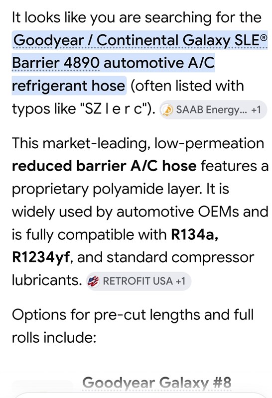

AC hose. There is a mob who do HVAC into the tubs of utes for dog handlers etc. Long shot.
AnswerID: 649662
Follow Up By: Member - nick boab - Friday, Oct 16, 2026 at 10:46
Gbc thanks . The vehicle might have been the Council dog catcher :)))
Update. Looks like you were on the money Gpc..

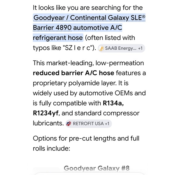

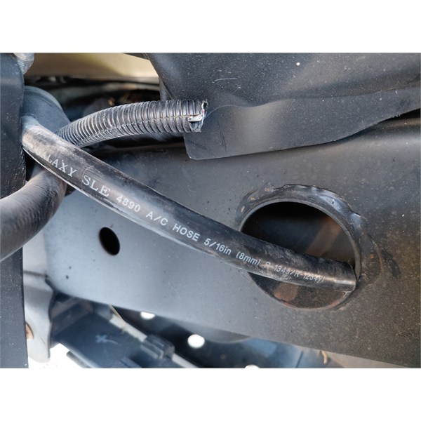

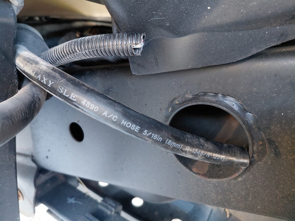

Reply By: Member - nick boab - Saturday, Oct 17, 2026 at 11:35
Hope everyone is enjoying the quiz :)))
what I have found since taking possession of the vehicle. It looks like it air conditioning hose there may have been some other items as there are a lot of wires a loom of 8 very small gauge, the fuse was a 5 amp which was tapped into the auxiliary harness.. purple with white stripe . The vehicle belonged to a leasing vehicle company, government and mobility etc .
