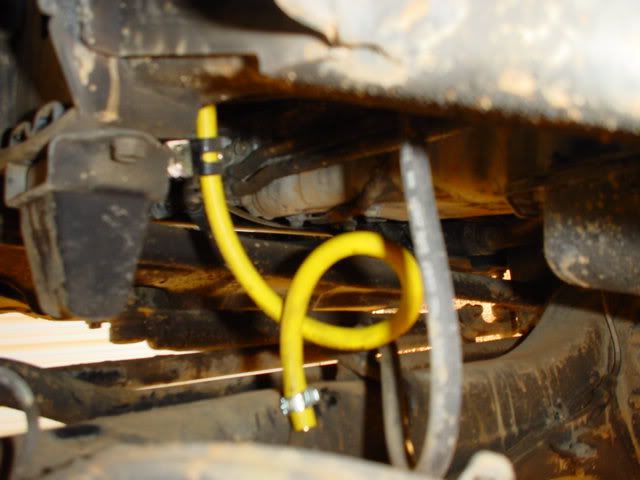

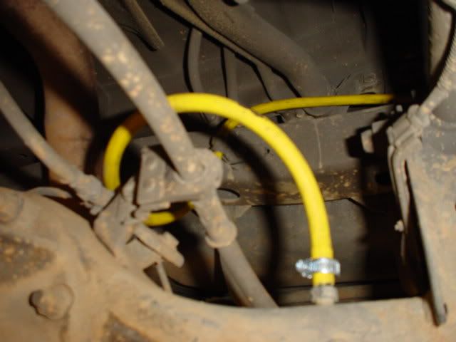

Finally got around to fitting these up today and boy what an easy job on a Cruiser.
Removed the rear breather extension and fitted the new breather hose on.Cut the g/box-transfer breather off just where it goes into it breather cap(top of bellhousing) "T" peiced this into the new breather hose running up from the rear diff,then "T"eed the front diff into it also.Then up the fire wall and fitted the rear breather cap to the end.This breather cap was in perfect cond but in future may fit a fuel filter on.Took about 40 min.

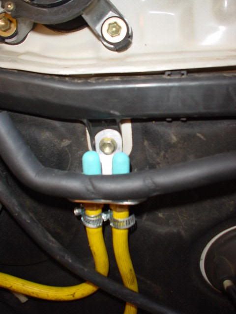

I also did mine on the weekend, it took me 90min and I haven't done my transfer case yet, guess I'm a bit slow. One thing I did note however was when I took the hose off of my rear diff there was a rushing of air from the diff, I guess I was lucky I decided to do them. I replaced my breathers with little filter looking things.
Hopefully these Links work.
AnswerID: 188950

I plan on using a T piece for the transfercase/transmission, but I need to wait to get some car ramps to make it easier. I had some left over air hose and used that it had a slightly larger id. than the original.

No kit used you can get those little blue filter things from RS components for about $3.50 each, I then used air line fittings from Bunnings and made the mount out of Ali angle, all up it was about $30 for every thing.
