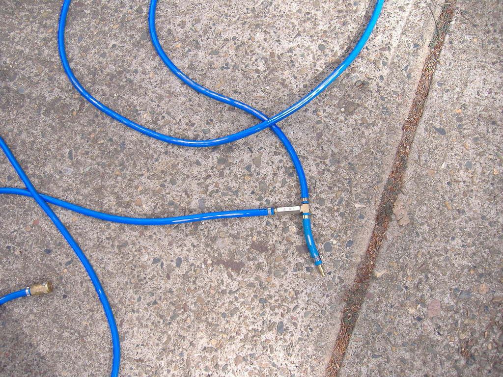

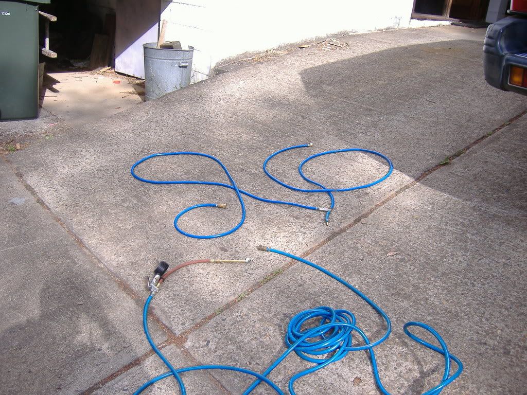

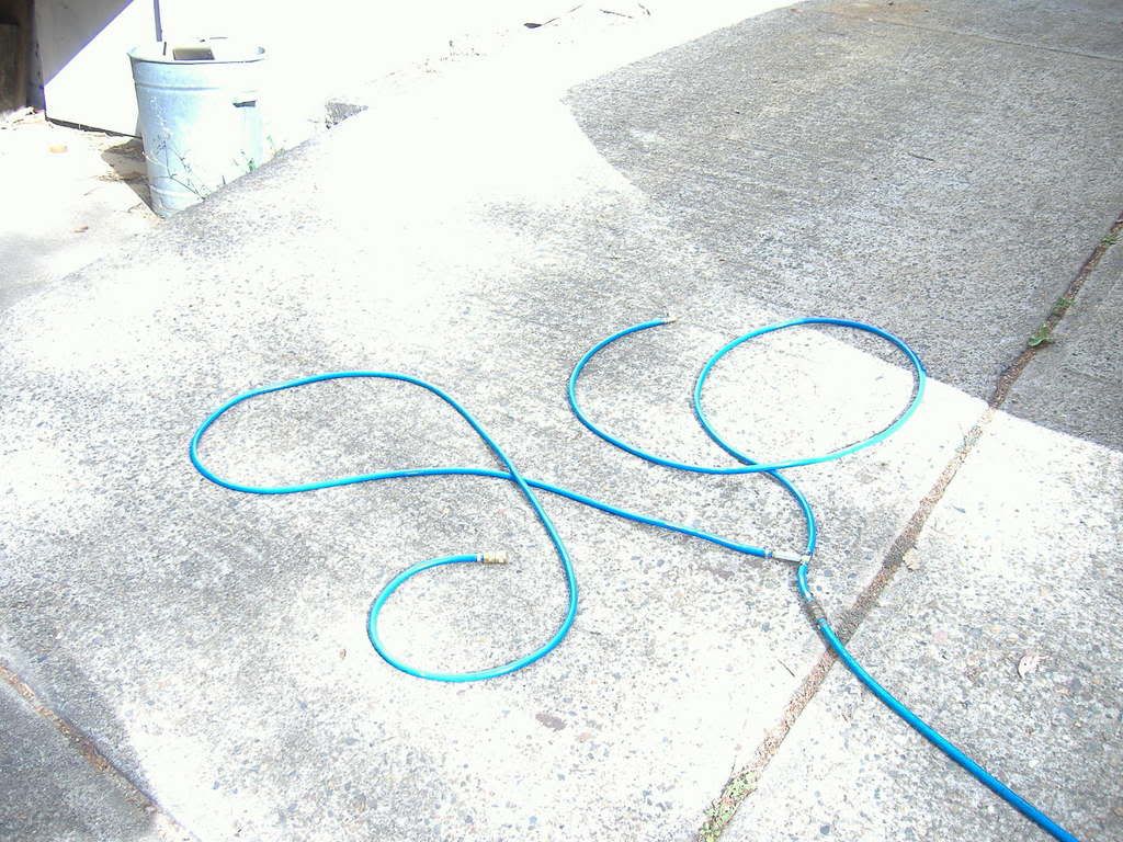

A couple of months ago I made up a new hose to run from the blue tongue pump under the front driver's side seat to the spare tyre.
Put a 'tee' in the middle so I can then run the standard hose off the new hose, with the same snap on fittings.
Whole set up.
This way I can run off both the spare and pump, off the spare only, or drop the new line and just run off the pump as of old.
These are the two hoses together.
Two hoses together.
The new hose also has a one way valve on the line from the pump.
Site Link
This way if I want to, I can just run off the spare tyre.
Site Link
To just use the spare, I run the spare at 70 psi, being a 10 ply LT tyre, maximum pressure is 80 psi.
When I have the CT on, it's spare is also at 70 psi, so I have enough air in both spares to put 15 psi plus in all six tyres, and as fast as I can get to the tyres. No waiting for the pump. It is almost as fast as garage air, but they use 12mm air line :o)
Having the pump running means that the spares are topped up between filling the tyres.
Cost about $120.00 to set up.
