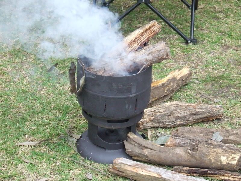

Those BBQs are great. I first saw one in use a few years while camping beside a Tassie lake. A man rolled in in a mega dollar motor home that must have had every possible cooking appliance inside it yet he pulled out this old home made gas bottle oven and proceeded to cook a beautiful roast chicken and vegetables in it.
I measured and photgaphed it and made my own quite easily.
I noticed the one shown on Barry Breaden's site uses a length of open exhaust pipe for a chimney. The Tassie one had a larger diameter pipe with a "throttle valve" type of disc in it to control the air flow. I found an old Falcon driveshaft that I happened to have lying around was the right diameter (67 mm inside) so I used that. It was a simple matter to cut a disc out of sheet metal and pivot it on a piece of 6 mm steel rod split with a hacksaw.
I have another bottle and intend making one with a gas burner ring in the bottom and a non cumbustable insulating tea cosy style of cover to slip over it. I am hoping I can get it going with a very small flame and minimal gas consumption, yet still have a very hot oven inside. That is the theory anyway.
I prefer to use a fire but this one should work well on fire restriction days.

Reply By: flappa - Thursday, Nov 29, 2007 at 09:33
Nup , no problems.
Here is mine
Left the valve open for a few days. Washed it out.
Cut
AnswerID: 274184
