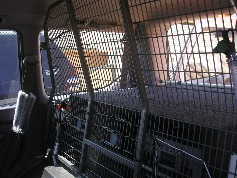

Reply By: Stephen M (NSW) - Sunday, Dec 09, 2007 at 16:50
Not sure if this will help or not this is from inside a Grande including water tank directly behind seat but in front of cargo barrier.

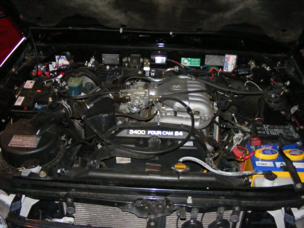

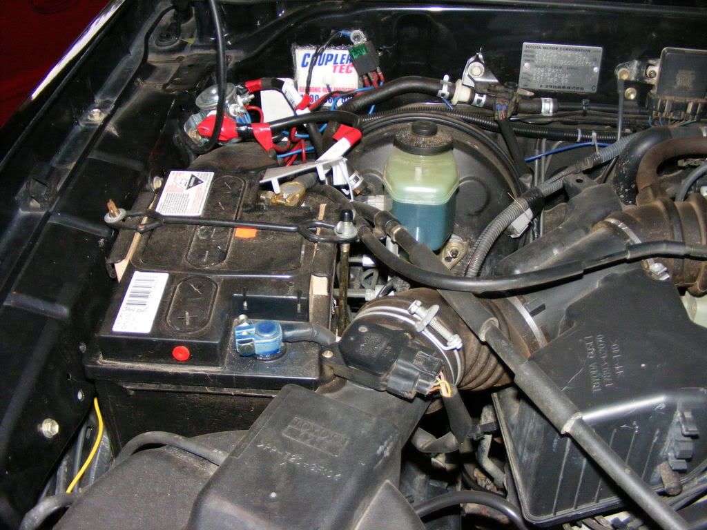

Reply By: PradOz - Sunday, Dec 09, 2007 at 22:29
see if these help. with the 2nd battery on the drivers side it was real easy to install - very simple actually. also since these photos i have added LPG which sits on the passenger side towards the windscreen edge.

Reply By: Member - Phil G (SA) - Sunday, Dec 09, 2007 at 23:13
Re the Cargo Barrier, it depends on the model. If you have a TX or VX with the dual airconditioning, there may be hassles - I know that Milford weren't doing one. No issues with RV or GXL.
Re batteries, heres some photos from the 90series V6. Its all pretty complicated, as you may have to move the charcoal canister and lengthen the battery leads, depending on the arrangement you want. I know a few people who simply upsized their starting battery to a decent N70 battery and then used a low voltage cutout set at about 12.0V.
