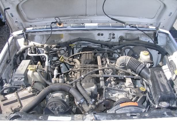

Hi, has anyone fitted a backup battery in a Jeep Cherokee XJS (1997)? If so where did you put it? I have been given conflicting information from specialist suppliers/fitters. I have been told that it will fit under the bonnet, but then I have also been told that because the Jeeps run a bit hot the battery cooks and will not last more than twelve months. Any positive comments will be appreciated.

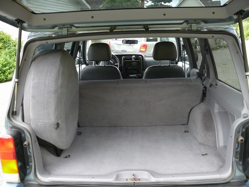

A battery specifically to run a fridge would be better placed near the fridge and if it's in the back of the Jeep use an AGM battery in a battery box.
No problem with any gas leakage and won't spill even when laid on it's side, they charge much FASTER than a wetcell battery and can be safely discharged further and more often too.

I would tend to agree with the heat issue in the Jeep. The battery needs to be mounted where there is not much cool air flow. The bonnets are already very cluttered and I would recommend mounting a battery pack or FLYER in the cargo area.
