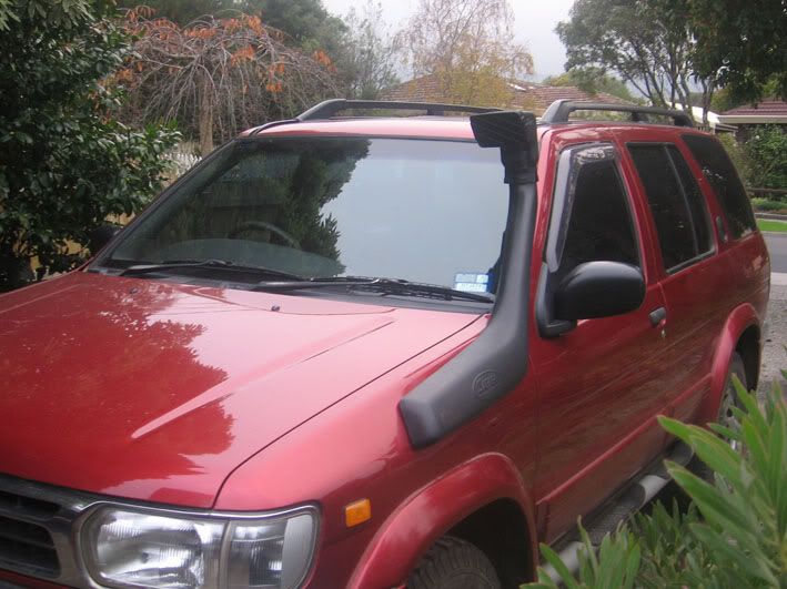

http://pcoa.org.au/forum/viewtopic.php?t=911&postdays=0&postorder=asc&start=135
I have seen R50's ford water about 60cm deep with no real issues other than leakage through the rear door seals.
I have also seen the result of one hitting water around 30cm deep too fast. He ended up getting a new engine as rods were bent.
AnswerID: 287668
Follow Up By: Hoyks - Friday, Feb 15, 2008 at 19:19
http://pcoa.org.au/forum/viewtopic.php?t=15&start=30
Here is another that looks a little neater. More modification under the skin is needed though.
