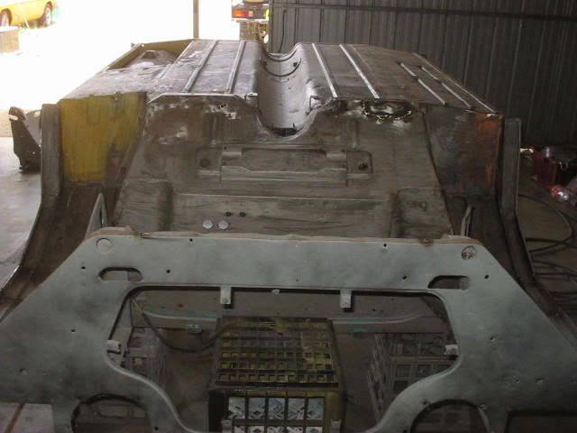

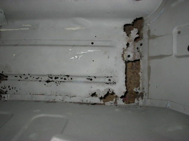

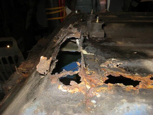

worked on my 60 and troopy when I do rust repairs on mini's or mokes I use a similar method and can guarantee my work

full spray job around 2k depends on paint poss another 1k to replace roof rust but if you are up this way can give you a firm quote
booked out till next november but can fit it in makes a change not to be on my knees to work (no smart comments) normally working on mokes or escorts
