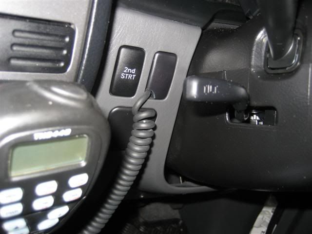

Follow Up By: Member - Peter R (QLD) - Friday, Jan 23, 2009 at 18:15
Willie,
Monitor was installed by a sparkie and the base (flat metal) that it sits on is firmly attached to the dash.
Sorry can't see what was used.
My UHF (3440) is attached , via 3M Double Lock as per the following
Image Could Not Be Found
As you can see the Prodigy brake controller sits in ashtray, and wiring to back of dash as follows
Pedro
FollowupID: 613640
