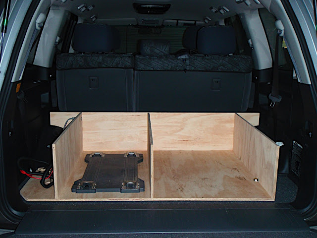

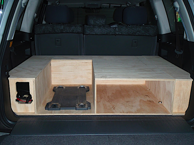

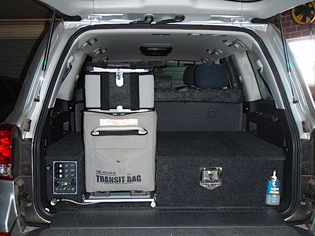

Hi gonebush SA,
Here are some pics of my drawers in my 200. It has the 40L fridge slide at the draw level, along with my ARB compressor, 60L water tank and inverter.
Hope it gives you some ideas.

hi, firstly a big thanks to those emails and replies i've got so far, one question though- is there enough air room around the fridge/freezer for it to work ok? it just seems that some don't seem to have much in the way of air flow. and how does the cord for the fridge stay in place when the fridge is on a runner being pulled in and out?
thanks again from chris, and keep those replies coming in the more ideas the better.

Follow Up By: Member - Captain (WA) - Saturday, Feb 21, 2009 at 23:33
On the Engels, the cooling vents are on the side and on the top at the back. Hard to see in the pic (engels with twozone) but I have about 50mm of room at the end for air. I have found there is more than enough room for the heat to get out (hot air rises).
I have a plug at the back of the fridge slide for the power, the cord just slides under the fridge as it returns, but gotta admit occasionally it gets caught if I don't make sure the cord is in the middle rather than to the side.
