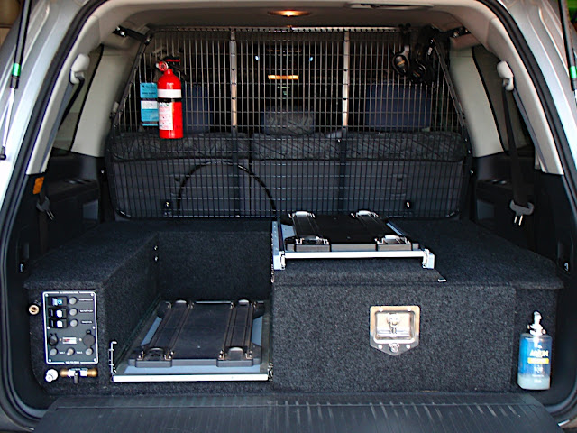

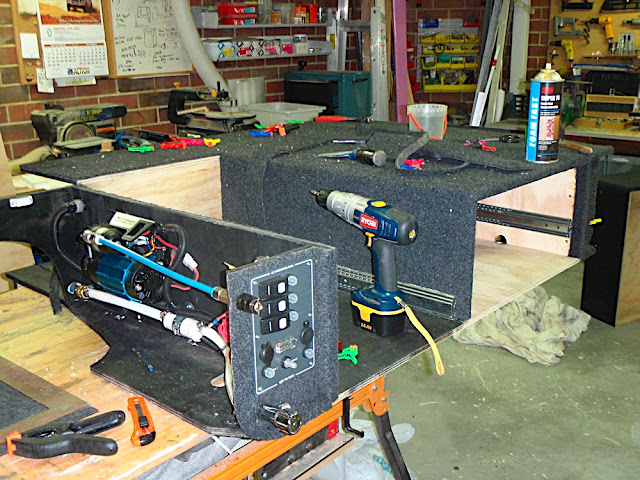

I originally used the blue tube and push-in fittings in a similar manner as you plan to. You can see it in the pic below of how it was installed.
However, my ARB compressor gets awfully hot and blew out the fittings at the pump end when pumping up my 4th tyre on a hot day. I have now replaced the blue hose with 1/2" stainless steel pipe and this seems to dissipate the heat much better. I would suggest that you use something more heat proof for the first ~1m of the air line.
Captain
