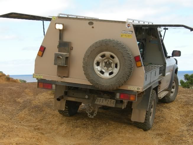

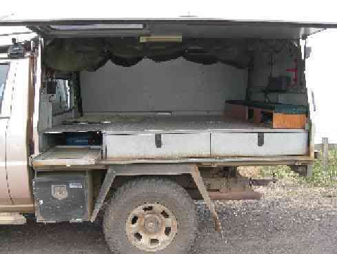

Reply By: Who was that again? (Vic) - Thursday, Oct 22, 2009 at 21:39
Burra, have just such a camp box sitting in my shed at home. It has sat on the back of my Nissan ute and I have used it with an Oztent along side, sleeping in the box. It has a 5' fridge slide and four drawers - two each side. There is a 'long storage'up the middle too.
