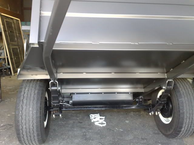

no Scoof,
The draw bar continues all the way to very back of the trailer, one peice. The cross supports for trailer floor, usually 50x50 are welded into the draw bar/chassis. Hence it is not your typical box trailer. Effectively the draw bar is also the chassis. Has to be better doesnt it? No welds.

I think you are thinkin different to me mate, the draw is as per normal but instead of stopping at the start of the trailer, the two peices are bent and straighten up to continue to rear. The spring hangers are welded off this, and the 50x50 that supports the trailer checkerplate floor are welded into the sides of the 100x50 RHS

found a pic mate

Now that is nothing like I imagined, this similar to my boat trailer. No angle cuts .
That is a good looking set up.Its been bent at the front were I thought it would of been cut on three sides.Very simple.
