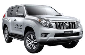

Hi Jenny
I picked my one up this week. It is the 4.0L V6 and compared to the diesel is a very powerful and high performance vehicle.
I know diesel will use less fuel but I enjoy being able to put my foot down and get instant power, especially when towing my Supreme Getaway on soft sand.
I will plan my trips well if there is a possibility of no fuel on any route as I have always done will my LC100 petrol.
I must say compared to my LC100 this drives very well and has way more power, will tow the Getaway with ease and will use less fuel than the LC100.
