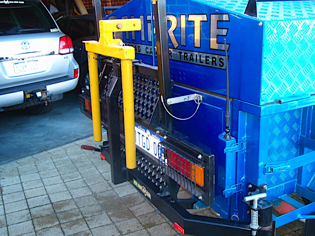

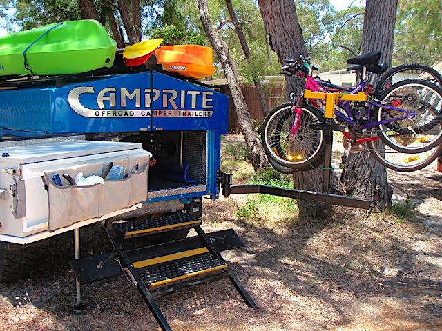

We have a rear bike rack on our Camprite trailer and it works a treat. As the pics show, its built very strongly and we have had no issues with it off-road. Its held in place by three over-centre clamps and the bottom bar rests on a bracket in two places to take the weight.
Bike Rack with bikes.
Bike rack swung out
Access to rear kitchen for roadside stop
Bike rack folded up when not in use
Captain
AnswerID: 397980
