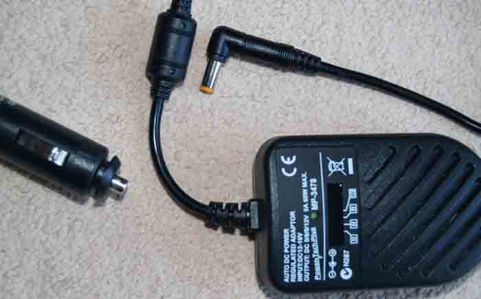

Some Pictures:
Firstly the unit
Secondly the leads:

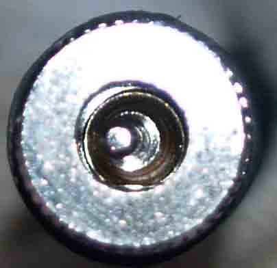

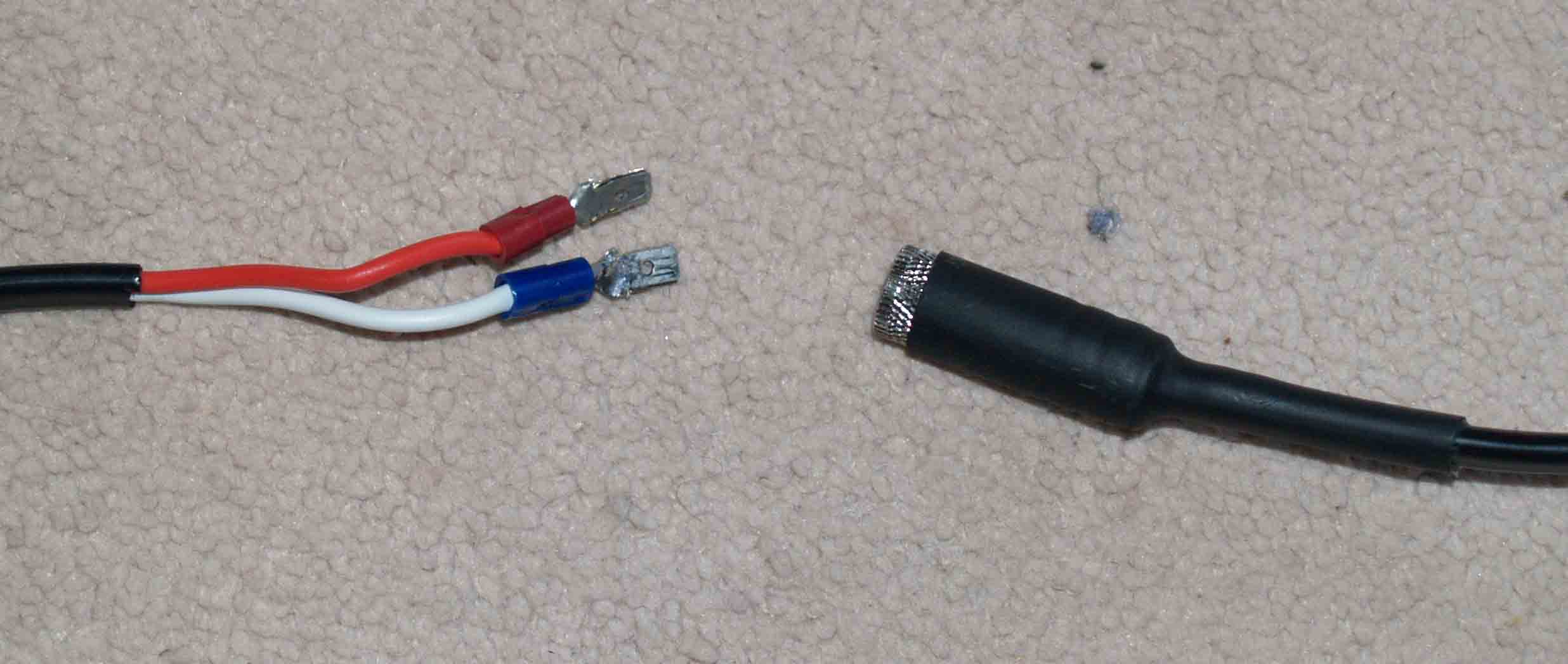

Blue lug on white wire is negative and Red lug on red wire is positive also note where i used the heatshrink
Thirdly I bent slightly in the femail connector for a tighter connection as in this piccy
The centre pin I bent connects to the red wire which in turn connects to the red lug. As you I have 2 male lugs coming from a power supply I ALWAYS CONNECT IT TO MY COLEMAN FIRST BEFORE PLUGGING IN THE 12V POWER in case the 2 males short....

here are the links for you to look at
http://www.cherokeeclubaust.freeservers.com/unit.jpg
http://www.cherokeeclubaust.freeservers.com/Lead%20Ends.jpg
http://www.cherokeeclubaust.freeservers.com/pin%20bent.jpg
hope this helps
