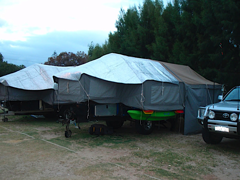

Here is a pic of the thermal fly on my Camprite and my mates Camprite. It works exceedingly well, makes a huge difference in both hot and cold weather and I would not be without it. It is simply made from reflective insulation and sewn together in the correct shape. To use, it is simply thrown over the camper and tied down, no need for an air gap as this is already built into the insulation.
Captain
