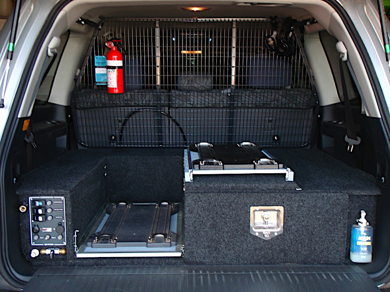

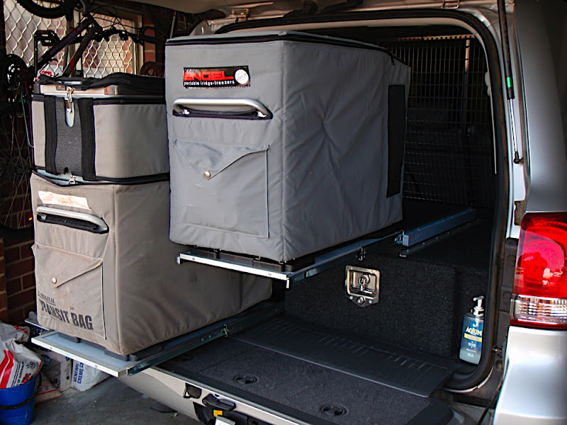

I use the Engels Transit Lok. You can bolt the Transit Lok to some plywood and attach that to the GU floor via the hold down bolt holes. Or you can put them on drawer runners and make up a drawer system to suit, I made my own drawere system as I couldn't find anything that suited my needs. I run two Engels and here is a pic of them
They hold the Engels very securely, I have used them for many years and have never had them come loose. Much quicker than turnbuckles or straps IMHO.
