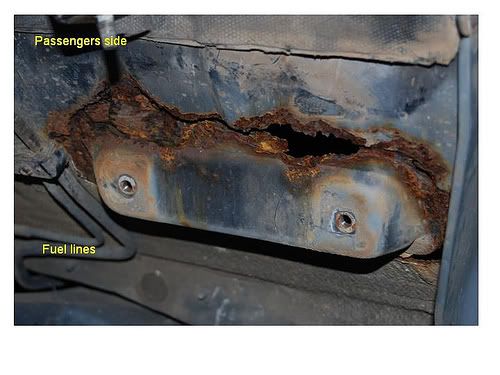

Nothing to do with your problem but is a potential for rust. Get under the front end and on either side on the fire wall is two brackets (one either side) you will see these two bracket type things with rubber bungs in the bottom of them just in from the guard brackets holding the inner part of the guards on. From what I can gather they were there purely for the manufacturing of the body (jig assembly maybe ??) Pull the rubber grommets out and leave out, for some reason they allow water in but wont let it drain back out again which obviously lets the water sit there and will rust through the fire wall and will end up costing a nice small fortune to repair
as per pic below........................................
