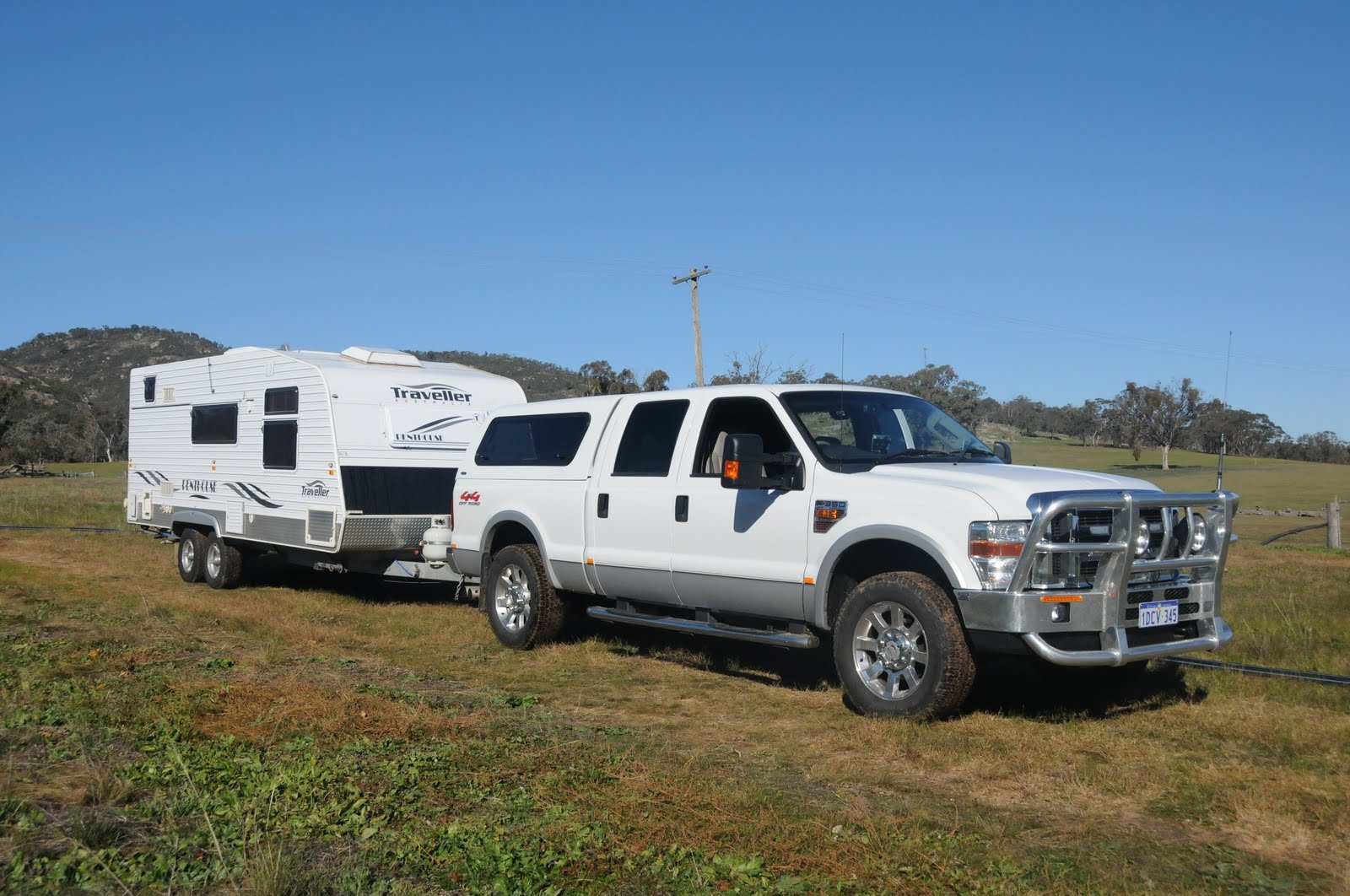

My experience with F Series is a bit different. I'm on my 4th,the current vehicle is a 2010 model. My advice for towing is to look for an F350. Pretty well the same truck but a little heavier sprung and has a lower axle ratio which tows better than the 250's high gearing.
My last 7.3 F350 did 12 years of towing on original brakes. Six months before I sold it I replaced the water pump which was worn out and also replaced all the belt driven accessories ,bar the alternator as a precaution. Parts are cheaper from the States and with filters I order and they are here in 5 days
Having had Landcruisers as well since 85 (including currently a 200 TTD)the F series are a vastly better towing platform and use less fuel. Last year we towed a 3 tonne van around the block and over 14,000 kms we averaged 21.5 ltrs per 100kms. A lot of smaller vehicles towing smaller vans aren't doing that.
http://4.bp.blogspot.com/_l8L7nJlHwN0/S_JWTa9-0MI/AAAAAAAAAEo/sHD0HrwBpUA/s1600/DSC_3183small.jpg
