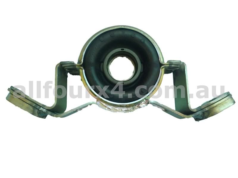

Sure its not the centre tailshaft bearing/rubber binding up when cold then is ok when it gets a bit of heat into it. Replaced myn due to it shuddering on take off.
AnswerID: 473349

Thanks for that suggestion hadn't thought about that. Don't think it is as the shaft was new when i got it and all looks good but will check it out. Thanks for your reply have a good new years.

I had good engine mounts, and gearbox mounts, new center bearing (trick for those about to replace theirs, before you fit the new center bearing, get some sika, I use the black stuff, and inject it into the rubber that holds the bearing in the middle.
By packing that void with sika, it stops the rubber from flogging out in 20k and will last alot longer than if you don't do it.)
