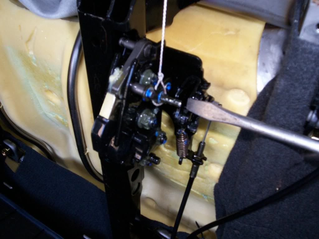

Hi guys I have a 05 paj the problem is the cable that releases the base of the seat when you lower the seat back has broken or just come adrift on the larger side of the back seat .
The only place you can get a look is on the side of the seat but you can't see nothing i tried fishing around with a piece of wire but to no avail.
Thought someone else may have had the same problem and new of a fix .
Cheers Ken
Reply By: megan z - Sunday, Apr 01, 2012 at 13:47
I have had this happen a couple of times. You will need to remove the plastic cover on the back of the seat base it will have a number of screws in it. then you will see 2 zippers on the outside of the seat base which allow the lining to be zippered away for access.
You should then be able to see the cable which will have come out of it's stay or in my case the handle had been pushed past the metal lug that is designed to stop it going the wrong way and unseating itself.

First thing was to get a short Phillips head tec bit and a small spanner t5o turn it with .My problem was the seat on the right side so there were 4 screws i had to undo in the back of the base ( the only ones you can get to ) Using 2 tyre leavers to prize the plastic base down and then 2 wedges to hold it down . Next was to jiggle each side of to seat to see which side was stuck . Looking in the gap there is a 20 mm long pin sticking out 200mm in from the rubber flap near the seat hinge on the right side for the first one 450mm in for the second one 50mm down from the round bar that runs along the top of the seat base you need to get a heavy piece of wire bending a sharp hook in it ,I had a extra long pair of pointy nose pliers that did the trick . Grab hold of the pin and pull towards you (it takes a bit of pulling to get it to release )
I used a hole saw to put a 25 mm hole on either side and bought 2 rubber plugs to go in them just in case it happens again REMBER TO GET TO THE FUEL PUMP IN THE TANK YOU HAVE TO GET THE SEAT UP TO REMOVE THE INSPECTION PLATE INTHE FLOOR
