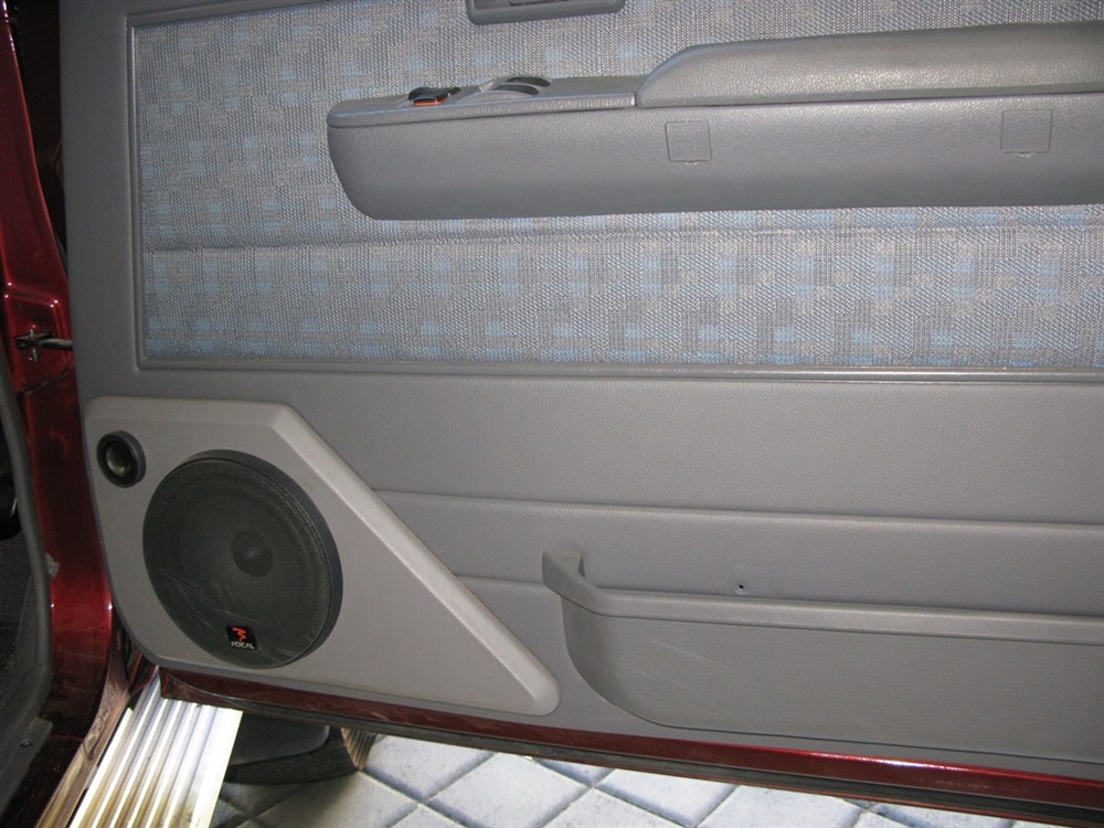

Follow Up By: Member - a convict - Sunday, Nov 18, 2012 at 12:03
Hi Allan
..two cents worth, suspect you will find spkr in doors
are a better local for good/better sound, just like pic below.
Big cavity seems to help.
Dynamat 'Extreme, ..do cab first, everywhere, wot u got
left divide between doors. U do not need to do all the door surface, do strips, like on Dynamat instuctions, it breaks up harmonic 'nodes'.
Too easy to do in door spkrs with door panels off. U can get 'clip together' plastic eyelets off the antenna people
for door-to-dash via way, and thread wire through 'heat
shrink' (ex Jaykar), measured against door in fully open
position, and the lot through eyelets, a touch of the hair drier, job will be solid, and possibly even water proof.

When I had my trayback I had these speakers put in the door.
Sounded good. I changed the head unit to an Alpine as well, that helped.
