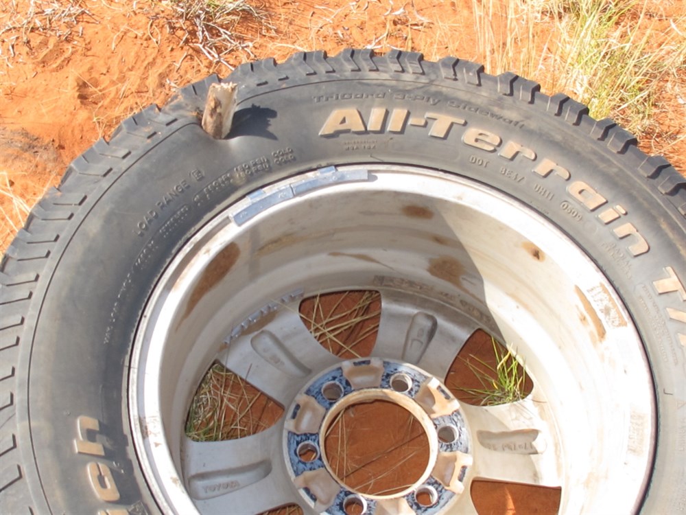

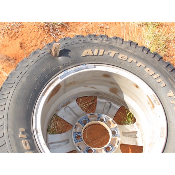

Follow Up By: Mick O - Friday, Nov 23, 2012 at 20:59
That's fixable and to Aust standards as well. Just need someone with a side wall vulcaniser. I know that the job can be done in Adelaide and Melbourne.
See you and raise you one Derek lol

Follow Up By: mudbro2 - Friday, Nov 23, 2012 at 23:12
You guys have a strange way for collecting firewood.
FollowupID: 775062

Follow Up By: member - mazcan - Saturday, Nov 24, 2012 at 15:21
hi
guys there not stakes there small trees

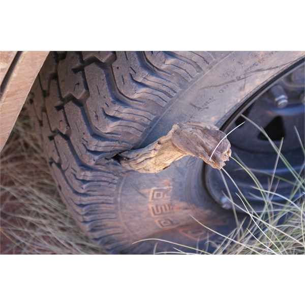

Yes!!!! you can eliminate it if you have a strong back.
With these.
Then again I destroyed one when it ripped part of the carcass open and the tyre started to distort as the foam started to try and force it's way out.

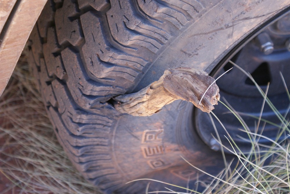

Reply By: Member - Stephen L (Clare SA) - Saturday, Nov 24, 2012 at 09:36
Hi Gibson
It all sounds great, but speak with any person that has travelled true off track remote desert travel and there are no tyres and are puncture proof. Many have tried various types and brands but at the end of the day given the right type of terrain, they will all get punctured.

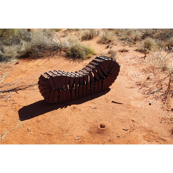

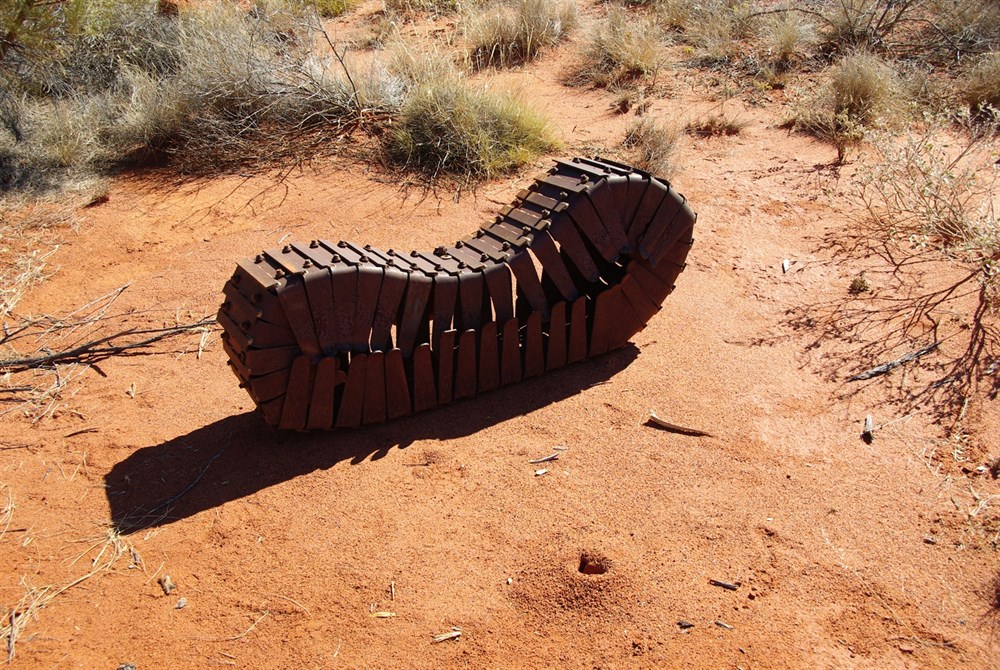

I have posted this picture a number of times that shows the means that very big companies that have more money than you and I to spend on trying to stop punctures in Mulga country. The picture was taken in the Great Victoria Desert when a US based company were looking for oil around 40 years ago.
How successful were they??????????
I never heard.
If you do find an answers, there will be many here on the forum that would love to find out about it.

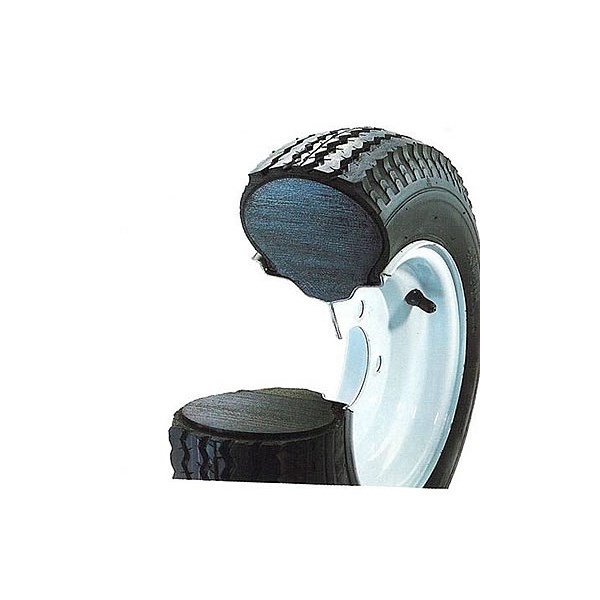

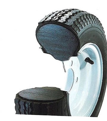

Reply By: pop2jocem - Saturday, Nov 24, 2012 at 11:19
Goodyear and maybe others make a range of tyres that they refer to as EMT (Extended Mobility Technology) or "run-flat". Awhile back we had a dealership that supplied a brand of ATV's to various mobs including geological exploration companies and the SAS. They had these tyres fitted either ex factory or we replaced before delivery. Even these could get staked in extreme conditions but without any air pressure you could still get home. I wouldn't even try to remove or fit without a split rim or a tyre changing machine. You will also feel the effect of much reduced weight in the wallet area after buying a set.
Pop
AnswerID: 499119

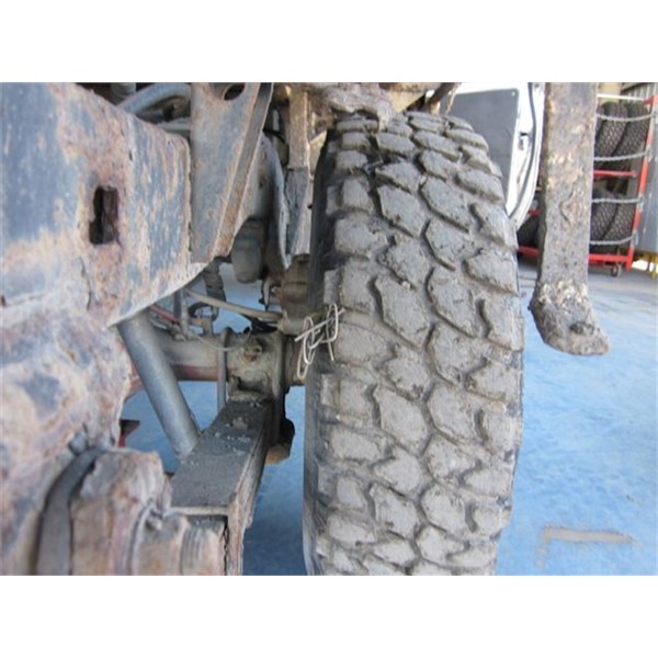

Reply By: Peter_n_Margaret - Saturday, Nov 24, 2012 at 14:06

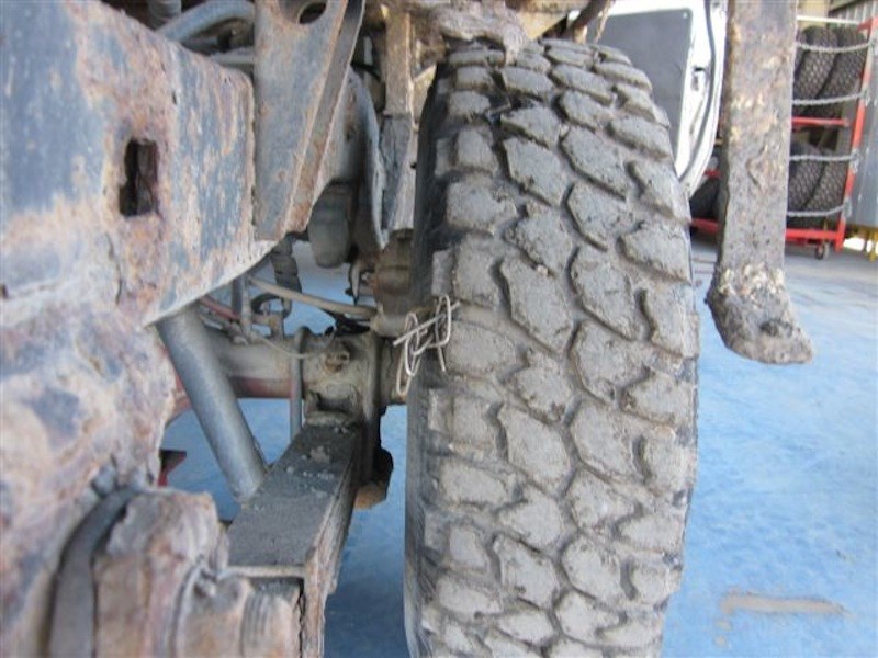

Another pic, just 'cos I can :-)
Nothing special about the tyre.
This is in the northern Pilbara and these vehicles spend 90% of their time 'off track'.
We run all steel Michelins on the OKA.
I have staked sidewalls (single ply steel) but have NEVER penetrated the tread area (5 layers of steel).
OKA196 Motorhome
