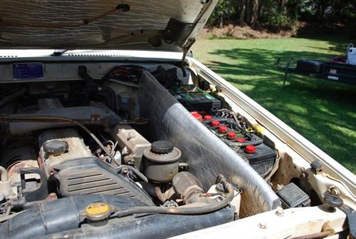

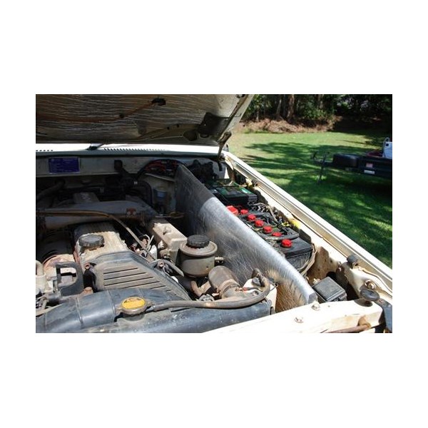

Hi Sludgie, My Troopy's bonnet lining was non-existant and I fitted a sheet of 15mm foam with an aluminium facing on each side obtained from Clark Rubber. It did reduce some engine noise in the cab and has stood up to the engine heat OK.
However on testing, the foam can be ignited with a cigarette lighter although it self-extinguished on removal of the lighter flame.
I used another piece of this material to create a thermal barrier for my batteries. See Thread 91116 for more information. The photo below shows both the bonnet lining and the battery heat barrier.

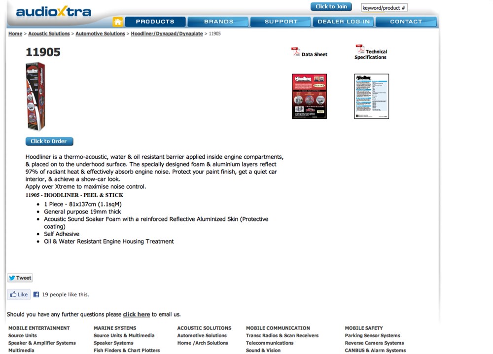

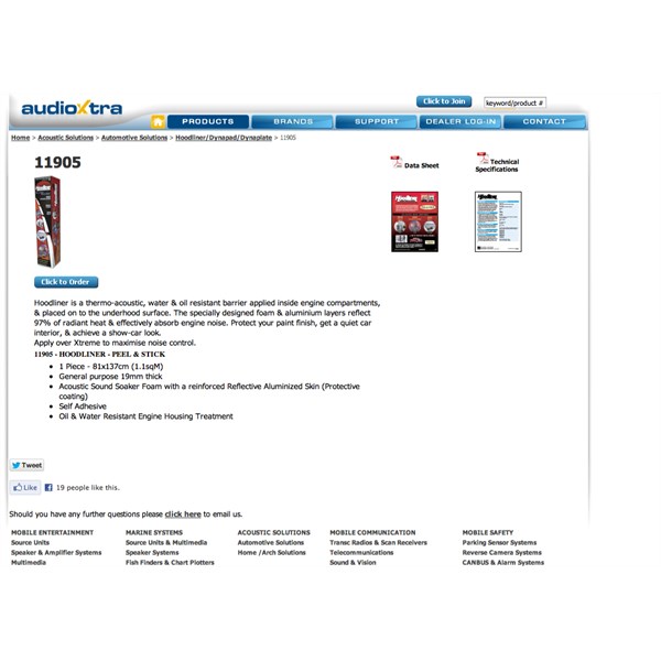

As an alternative, there is a product called Dynamat Hoodliner possibly available from Auto-One or Opposite Lock in WA. (See below) It is probably more expensive than the Clark Rubber stuff but possibly a better product. I have just purchased, but not yet fitted, a similar Dynamat product to insulate the cabin floor and doors from heat and noise. This is a self-adhesive loaded butyl mat, not foam.
http://www.audioxtra.com.au/PRODUCTS/Acoustic-Solutions/11905-.asp

Follow Up By: Member - Phil G (SA) - Tuesday, Nov 27, 2012 at 17:48
Gday Allan,
I wouldn't use the aluminium stuff next to the battery - too risky - might cause a short and a fire.
phil
FollowupID: 775292
Follow Up By: Allan B (Member, SunCoast) - Tuesday, Nov 27, 2012 at 19:45
Nah Phil, my battery terminals are well shrouded. As well as that, if you look at the photo you will see a rubber insulating patch near the bonnet hinge which is above the aux. battery +ve terminal and there is another out of the picture above the cranker +ve terminal. Also, there are insulation patches on the vertical heatshield aluminium adjacent to the terminals.
I think I've got it covered...... literally. LOL
FollowupID: 775295
Follow Up By: Member - Phil G (SA) - Tuesday, Nov 27, 2012 at 20:49
Gday Allan,
I still wouldn't do it myself!
But its not a good photo for a public forum because one of the punters will do it... thinks it looks OK....then shuts the bonnet which quashes the aluminium onto their uninsulated terminals (I'm amazed at how many people don't insulate the pos terminal) and shorts them out causing the fire!
It needs a huge disclaimer!!!
FollowupID: 775305
