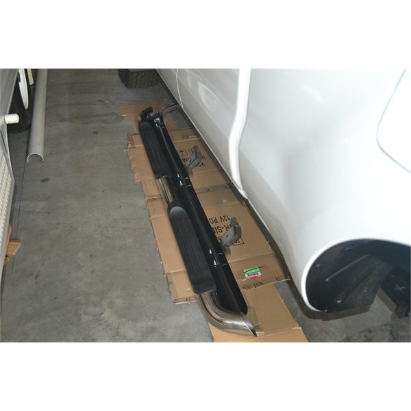

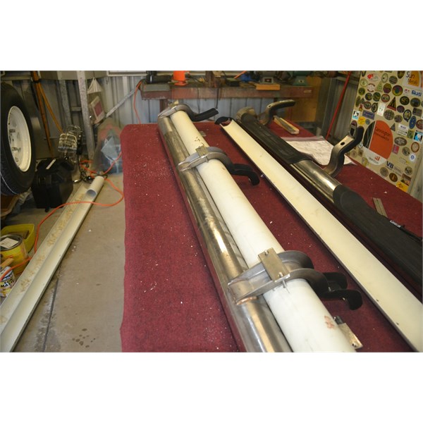

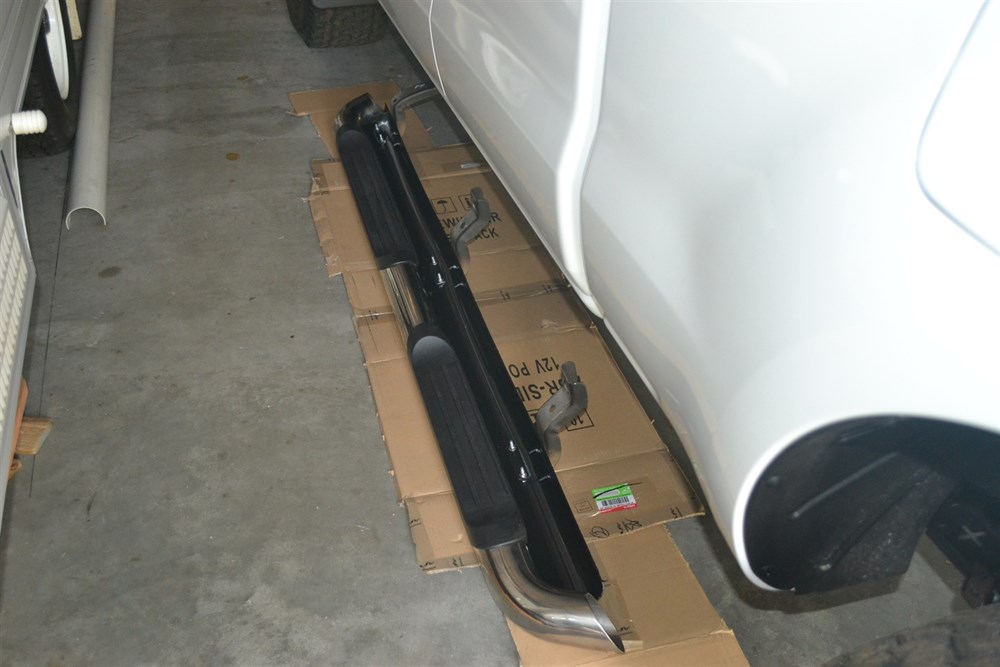

I have received my Ranger and one of the first things I noticed is the side steps don't protect the sills.
All of us would have suffered this on any vehicle that runs on gravel roads. Both my old Troopy's sills were hammered and the buckets of puss I owned before that I couldn't care less.
Now this vehicle is different. Cost an arm and a leg so I wish to look after it.

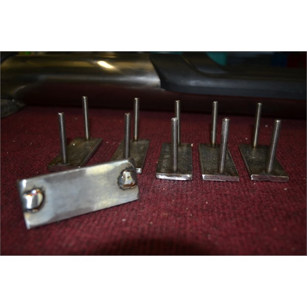

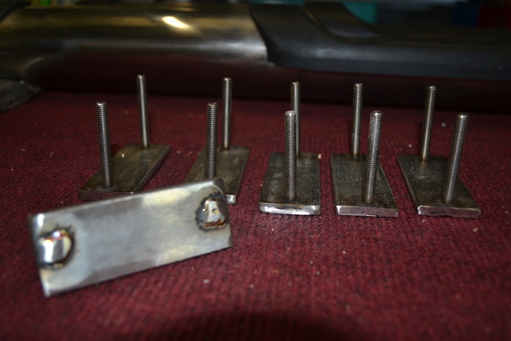

Cost to do this was very small. I had the 90mm downpipe plus the stainless bar and welding rods. I had to buy the 6mm stainless booker rod for the brackets and I had the paint and stainless welding rods.
This whole exercise cost $4.60 for the booker rod, $1.70 for the nylock nuts and $16 for the underbody pain and my time.
Here are some photo's of a simple way to stop stone damage with this style of side step.
[gi]69543[/g
[gi]69544[/g
Hope this will help someone.
RA.

theres only 1 photo you said some photos??
isnt the pvc channel going to fill up with mud/dirt or have i got my facts of how it fits on wrong
AnswerID: 499604

Yep I see that the other photos didn't arrive. Stolen I suspect.
No I don't see a problem with mud or dirt as they can be flushed very easily. They are open from the front to the back and will be easily cleaned. I will try another photo now.

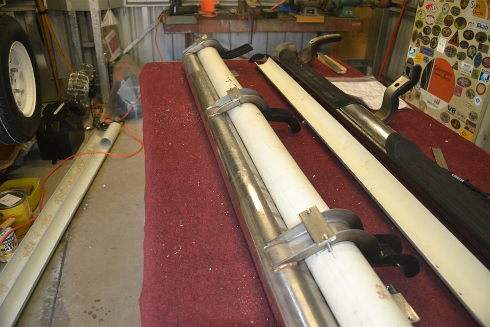

Number 3 photo.

thanks that better yes they should do the job and are cheap to replace if they got broken
those half channels could be used to carry tent poles with quick ties around them or maybe a row of cans or beer lol

Great idea you came up with - simple and cheap sill protectors that when painted the right colour no one would notice them.

With the side steps installed you don't notice the protectors at all and the rocks should just bounce off the pvc pipe. A 6m length of pipe is under $10 so all you need is jigsaw and a plane. I actually tapped the plate and then screwed the booker rod in and welded the studs to stop them turning. They come up from the bottom so nothing can damage the threads or nuts.
