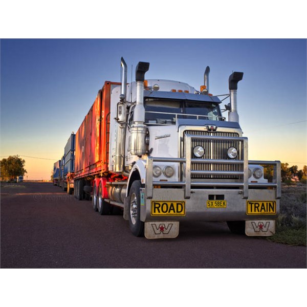

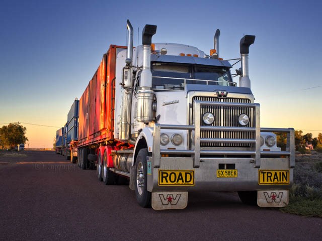

All earthmoving gear and trucks have their intakes as high as possible for a reason.

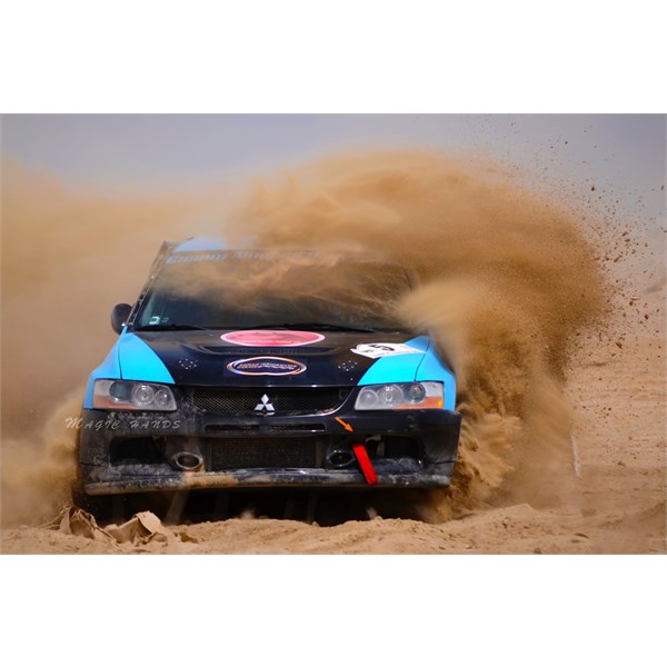

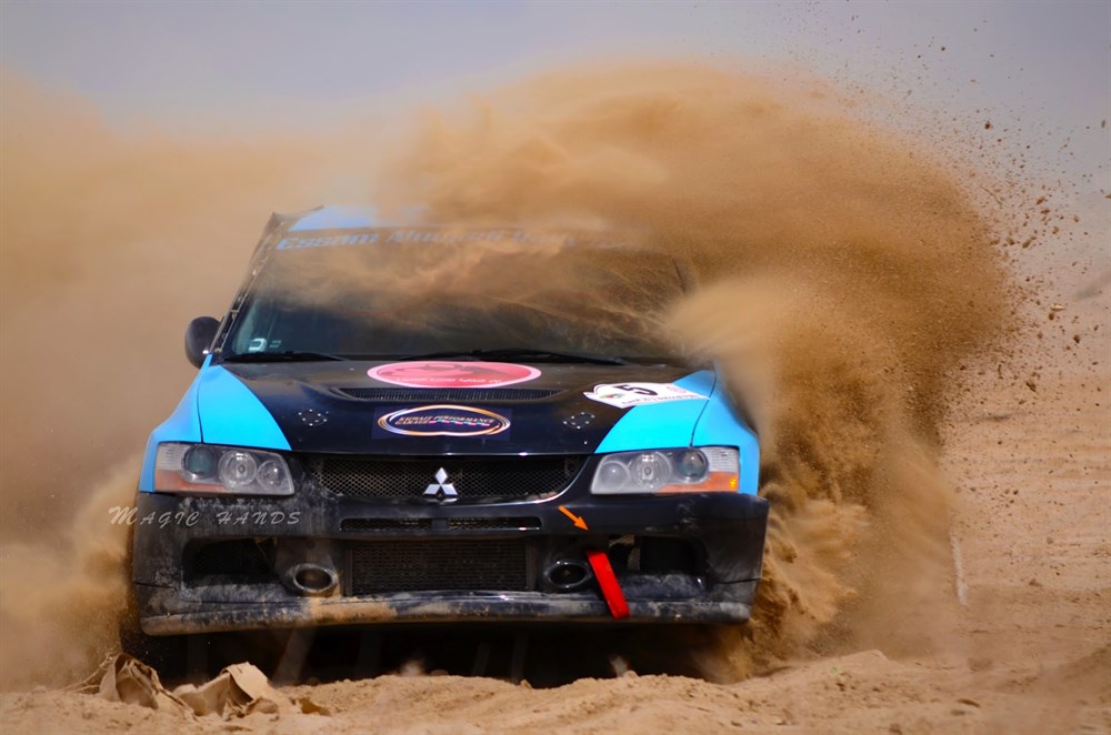

Just for fun , this guys happy he has no snorkel RA.
This post is about snorkels Dennis - but if you put up a post about diesel/petrol with some arguements in it I will answer - but you might get surprized.
FollowupID: 775706

Good photo.
But I don't slide my 4wd round corners like a rally car or through bulldust like a madman. It is a good way to come unstuck. I also don't get to rebuild my engine after each use.
Transport companies don't put things on vehicles that don't work or add weight.
