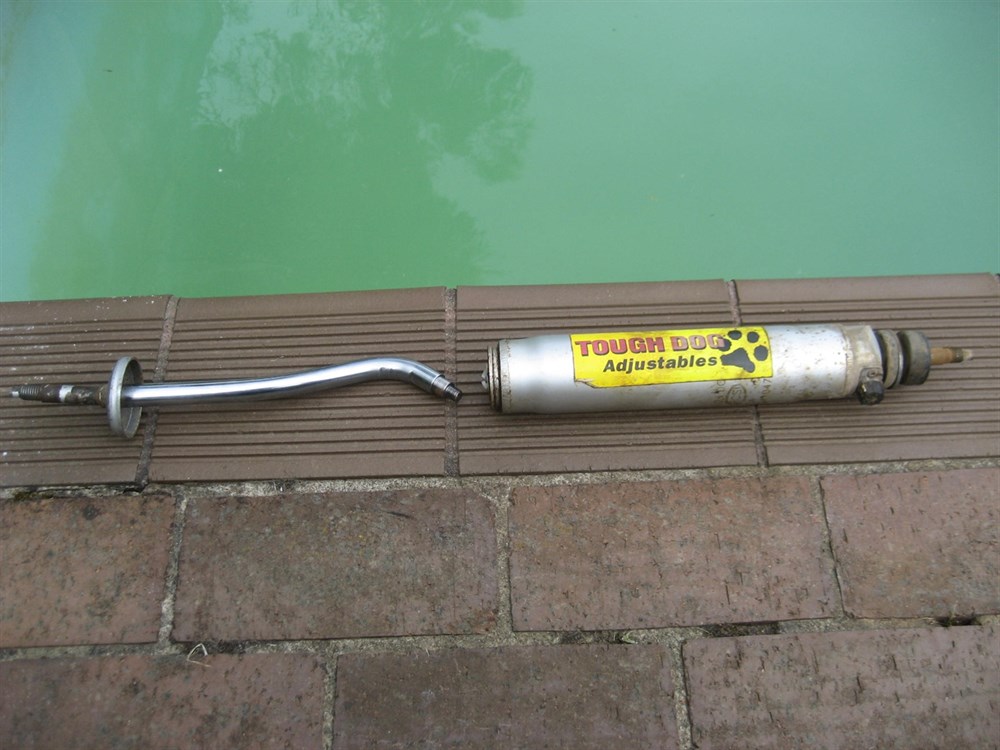

Many 4wders, myself included remove swaybar links or alter the suspension with
stronger springs etc to get that all important wheel travel.
The post shows what can happen to shocks as a result of not getting in quite right.
We had a few 4wds on our motocross track over the weekend and one Patrol (no not mine) has stronger 2in lift springs but also removed the swaybar to get a bit more suspension travel as it was having problems with the 1/2 meter deep ruts.
Unfortunately a wheel dropped into one unseen rut and the stronger than standard springs pushed the wheel down such that it thru the shock to its maximum length very
quickly. With no swaybar to limit the extension you can see the result.
This shock is a much stronger than standard Tough Dog item with an 18mm hardened
main shaft , it looks like the shaft didn't quite come all the way out at first and
kinked over, then repeated thumps did the rest.

To use a suspension without the sway bars connected (except quietly driven on tracks and using the flex) is asking for disaster as the whole dynamics of the vehicle would be altered for the worse and possibly dangerous too.
The shock you have shown indicates the springs of the vehicle have far more down ward travel than the shock has. It will therefore, when a sway bay is also disconnected, fire the shock immediately to the limit of it's travel and pull the end off.
The shock shown is was in no way matched to the extension ability of the spring, so what else would you expect the shock to do when driven past it's extension ability.
The idea is to have a shock which will allow the axle to be lowered to the extent the spring demands. Something which appears to be severely lacking here.
The shock should be just getting to the end of travel and lowering the axle as the spring is also just getting to full extent and then it won't be hammering the shock to full extension, hence no failure will/should occur.

Its quite a common occurrence though.
Few I have seen use limiting straps anymore like rally cars.
It can also makes things better all round if done right - some shocks like this one also have internal rubber stoppers that cushion the end of travel forces - not enough though in this case. (It has springs using 21mm dia wire)
All a bit of a balancing act - in my own case the shocks are painted around the circumference at each end of travel and then we run them over a ramp.

Ross you mention about the shocker length not being matched with the spring length...... if you had a shocker matched to the spring length in this application you would be limiting upwards travel and you would be punching the piston through the end or bending the shaft when the shocker topped out...... unless the upward or downward movement was equal when the vehicle was sitting at rest.
To longer shocks with no downward limiting can make the spring fall out
You will never get a shocker on a standard suspension set up vehicle to mach the spring length...... it's all a compromise, Hence why you have bump stops to limit upwards movement and sway bars to limit downward movement. and in comp vehicles suspension straps.
The other thing you have to watch for is spring binding.
There is noting wrong with this shocker getting used on this vehicle with these springs..... it's the person who disconnected the sway bar who was wrong. And there is nothing wrong with the factory suspension design but there are limitations.

As I understand it some shocks can act as suspension travel limiters while others are definitely not designed to do that. The second type rely on travel limiters of some sort such as straps or cables or the suspension binds up sufficiently to provide a "soft" landing at the end of the stroke.
The reduction in suspension binding caused by disconnection of the sway bars and the extra force of the heavier duty springs would appear to be more than enough to cause the damage you encountered.
A heavier rebound setting on the shock valveing would help reduce the shock loading as the shock tops out, but as this may interfere with normal handling, then I think fitting limit straps is a better option. This has other advantages in ensuring you brake pipes never become your limit straps (no it doesn't work), or on independent suspensions you momentarily bind up ball joints or driveshafts which then can cause them to fail later.

Good point about re-bound dampening.
I have some sets of shocks for the Patrols with different characteristics.
The Ironman set has very little dampening on extension but strong rebound - so maybe it would be worse in this case.
To confirm your comment, this broken shock has an internal rubber stopper which helps take the load on extension but this car had huge 21mm diameter wire coils to help with 80kg of winch/bullbar loading whereas my own car only has 17mm dia wire which would give less downwards kick.
(I also use no swaybars - but hopefully have set mine up better and adjusted brake lines and breathers etc whilst on my ramp- ).

I doubt that removal of the sway bar alone would cause the sort of damage in the picture, it is more like the shocks and the springs where not matched.
If a ift is being achieved by use of springs that allow the suspension to drop further longer shocks are required.
Many shocks can be ordered as standard or in various lifted lengths.
But this is typical of people fiddling with their suspension and not knowing what they are doing.
Most leaf spring suspension are limited by the leaves, although some like the early landrovers had limiting straps under the axle.
If a vehicle is designed without a stabaliser bar....that is all fine and beaut......but if a suspension is designed with one.....you had better knwo what you are doing if you want to disconnect or remove it......mostly that is is illegal
