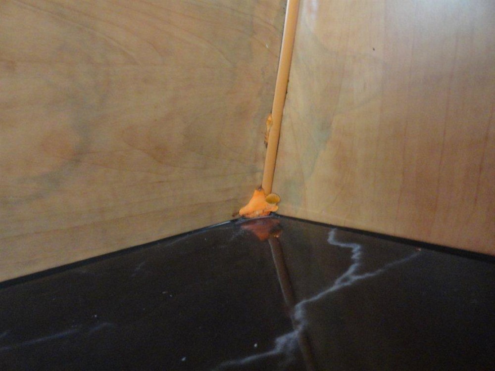

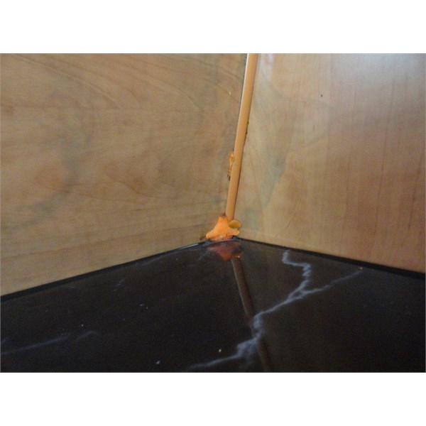

I am currently working for an elderly couple that have a caravan. Vans and camping have obviously become a centre piece of discussion. They posed me a question, that as being a novice, I can't answer. I did however tell them, `don't worry, I know some people that can!! '
So here is my latest question on their behalf.
Apparently they have some kind of orange goo accumalating on their work top where the front corner of the van meets the side wall on the interior. It appears to be coming down from behind the finishing strip the is the corner cover.
They wipe it away, but eventually it comes back and they just wipe it again. The lady removed some and showed me. It ends up as an almost sponge like substance and is bright orange. Any ideas???? I've posted pic to help analysis.

It's a wood fungus.
My weeping Silver Birch trees attract it on old dead branches. Also have seen it many times on pieces of old timber/wood that have been left lying around in damp conditions, like alongside of houses etc etc.
Cause - Water leak/s somewhere, maybe when cleaning that benchtop down.
How do you get rid of it in the caravan you have shown - I would respectfully suggest there is no other way than pulling that wall lining off from the corner area shown and then cutting the affected areas out. It might even go down under that bench top.
If ignored it will eventually work its way through the existing wood that it has attached itself to just like rust in steel and is also a slow mover like rust.
Someone may be able to suggest a 'product' that may kill the fungus, however it is usually only a short term visual effect as this stuff is like rust, once it is there, you have to cut it out to eradicate it.

Yep, Wood fungus,
Not a good sign as it generally means there id moisture back in there somewhere probably from a poorly sealed bench top. As DD suggested it would be best to pull the lining off and see how far it has spread.
Problem is that once the wood is infected with the fungus spores it is very difficult to get rid of.

Another vote for a fungus. The wood underneath the lining is most likely starting to decay, so will need to be replaced. Take care to check all wood around that area as fungi can spread considerable distances. Bad news unfortunately.

Oh yess yet another vote for a timber fungas...and this is not from a leaking bench top.
This is the fruiting body of a well advanced fungal problem..and to support this there jas to be some wood there that is permanently wet.
Unfortunately is is all too common for caravans to leak and the timber frames to rot.
Caravans may look all fancy and expensive, but unfortunatly all to often they are rough and poorly sealed.
AND it needs to be dealt with sooner than later, because the damage is pregressive and ongoing.

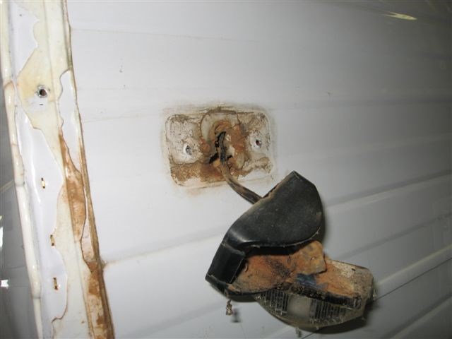

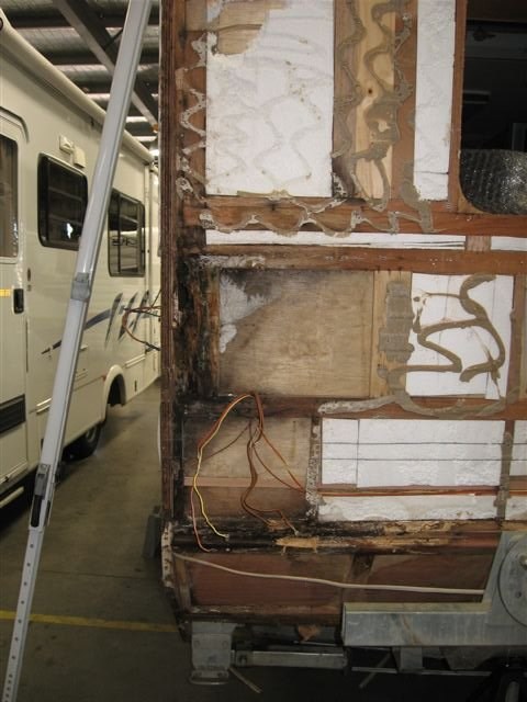

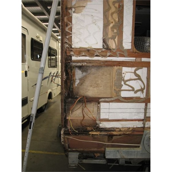

Follow Up By: Member - Niss42 - Saturday, Dec 08, 2012 at 12:23
Defiantly something leaking above there going by the dark stains on the wall lining. Just had a simular problem repaired, thank goodness for insurance, $3000+.
Mine was a badly sealed high clearance light, had to rebuild the frame,replace lining and cladding.
Barry.
FollowupID: 776001

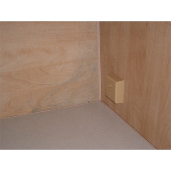

Thanks Bantam ,Yep that's us (The Elderly Couple ) hence the Nom De Plume, Old Codger . The Damage is actually worse than the picture above it is over on the left of the window as well as the right and is a big circle of bubbling of the veneer

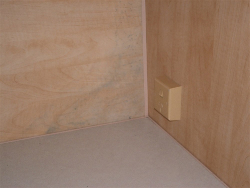

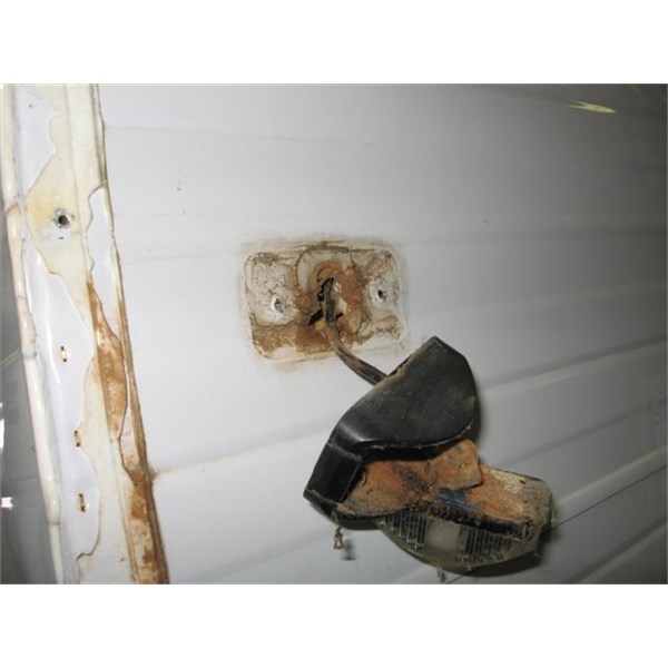

G'day Old Codger, I have added 3 photos of what to expect in the wall.
Good luck, and do try Insurance, worked for me.
Barry
FollowupID: 776596
