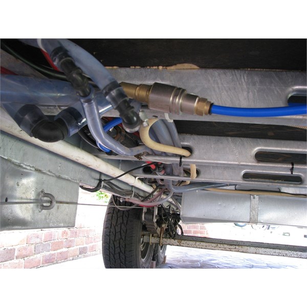

I have a 2009 Jayco Outback Sterling and have also had some water problems which I think may be related to the under van water pressure regulator.
It may be that you have the same issue although my water does come back on after a time of using the water via the pump which of course is coming directly from the tanks.
I am still trying to solve the issue and in your case I suggest the first thing you do is to check the little water direction indicator on your water pipes under the van.
The arrows should run horizontal with the van .
If this does not solve the issue then I am guessing the regulator is the culprit.

Most likely your pressure reduction vlave.
There is also a non return valve in the line as well somewhere which could also affect it.
I guess the only solution is to talk to a plumber or see if you can pull the non return and pressure reduction valve out ad have a look.

More often than not the water flow returns but it is NEVER at a high pressure so this tends to make me think that it is the pressure regulator.
I recently had a mate who is a water technician (does water reticulation for wineries/orchards etc and who is pretty handy with his van handy work) and he reckons the regulator is faulty.
His suggestion was to take it out completely and replace it with more pipe. He sayspark pressures are never high enough to damage any thing within the van.
Hope you come up with a remedy soon.

Hi Dan. I had the same problem recently when camped at Curlwaa. The water is supplied from the park's own pumps so there is not much pressure. I removed my pressure reducing valve, undid the inlet side and removed the little plastic valve and spring. There is also a gauze strainer in the that had a bit of rubbish in it but my main problem was not enough pressure to open the spring tension. You have reminded me now, I haven't put the valve back together. Cheers,Bob

Some Jaycos use a Filtamate FM-12-350 Pressure Limiting Valve just behind the water inlet. The two "O" rings in it, mainly the lower one, stretch and need to be replaced.
