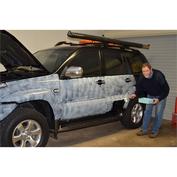

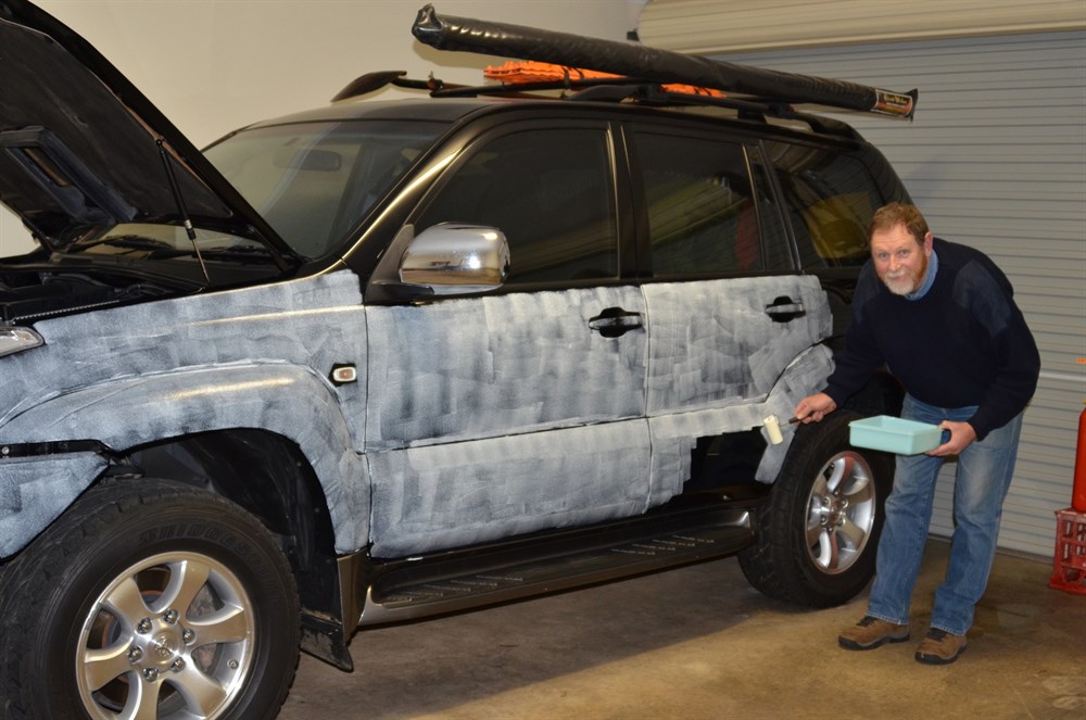

I used a cheap 4" roller for the sides of the car, and the first coast Fiona said "what have you done to our car". It dried to a dull finish and when you touched the side of the car, it felt a bit like rubber.

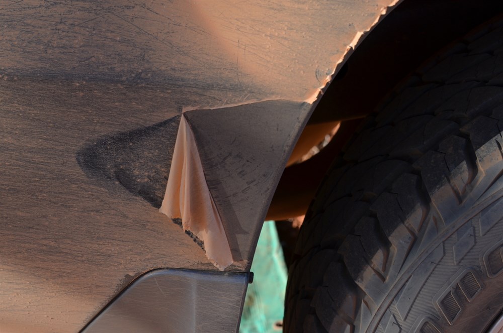

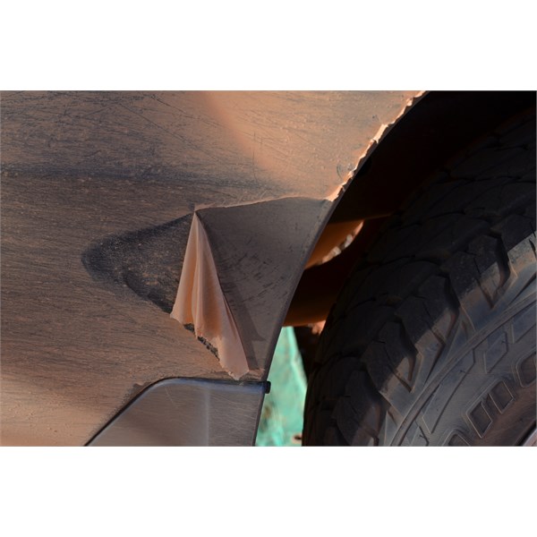

Here is a picture of it starting to peel off of my car after some rather tight bush situations. It remove it, just wet the car and it peels off it large sheets, just like glad wrap.

Here are 2 images and they speak for themselves. I gave the car 3 coats, but could have given it more.
I did what they suggest, and gave it a usual polish before adding the product. The next image was taken when we arrived back at Emu after heading up on the Dingo Track.
Like I said, it is the cheapest pre trip investment that you can buy and at only $39 a litre, it should be on anyones list that goes bush. As for removing it, it is just like in the link I included.

Stephen, it looks as though you are putting "frosting" on for Christmas.
Did you add tinsel? LOL
