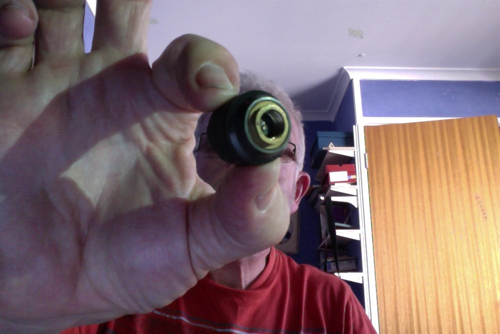

I have a Tiredog Sensor that connects, but shows zero pressure. It is possible it is blocked, and wondered if anyone has ever tried to clean or disassemble one?

I just had a look into a Tyredog sensor and there is a small hole which could become blocked I suppose but I would consider it unlikely. Does it still transmit a sensible temperature reading? If not then I would suspect an electronic fault.
Although experienced with small electronic instruments I would not try to dissemble one of these. Possibly better to contact the Australian distributor who is Zylux Distribution Pty Ltd, 166 Christmas St, Fairfield Vic 3078. Phone 03 9482 2203, email info@zylux.com.au and website www.zylux.com.au.
